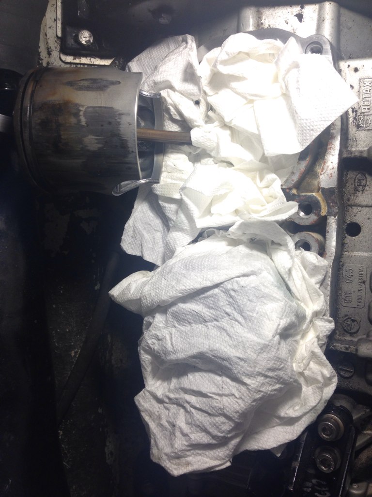

If I have sometime during the day, I will go back to the boat and get the pistons off the rod. Are they super tight on the rod?
No they aren't super tight, any man of even small stature with girlie hands can pop those right off there with no more effort than opening a bag of beef jerky or trail mix.

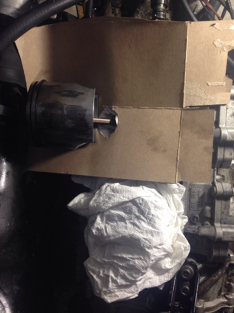

That comment he made about not dropping the *pings* into the crankcase? Cover it well, cover it some more and cover it again. Those covers will save your hind end when things finally come loose and you discover the bearing cage is no longer in one piece.
Yes cover cover cover

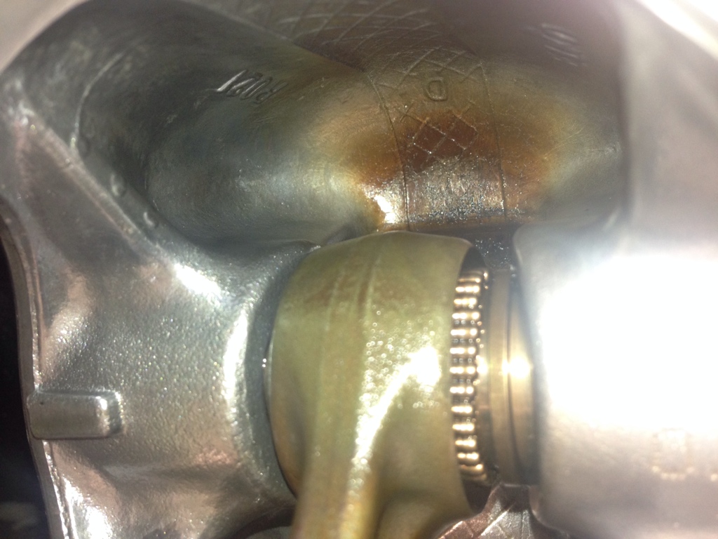

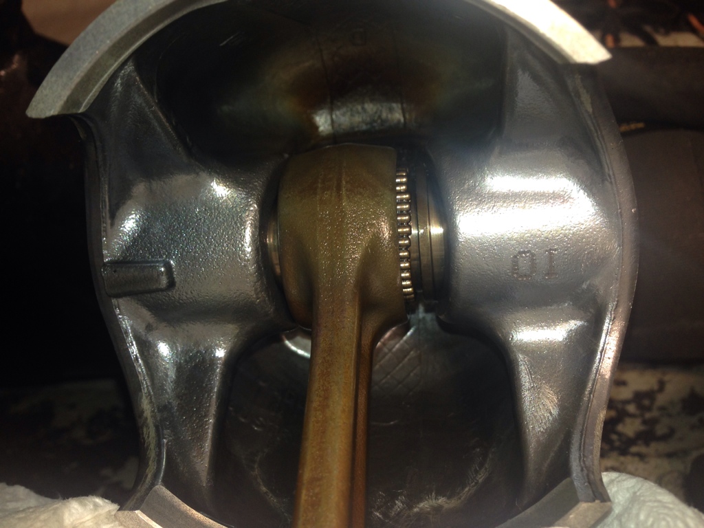

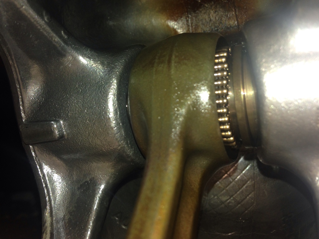

This is for sportster
In side the skirt. Super clean :-)
With yellow high temp mark.
Yes the centre pins are very loose. I can push it back and forth.

Need to find a longer socket to drive the pin out. Loose in there but tight when it is coming out. Into meeting again. Later.

The pistons are still on the rods. Pin is 1/2" out.
