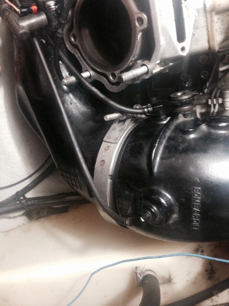

Wow, is that the damaged cylinder? Certainly there was an air leak there!
Yes. It is the one with color and lines

Perhaps this is possible, probably have to remove the mounting bracket bolts?

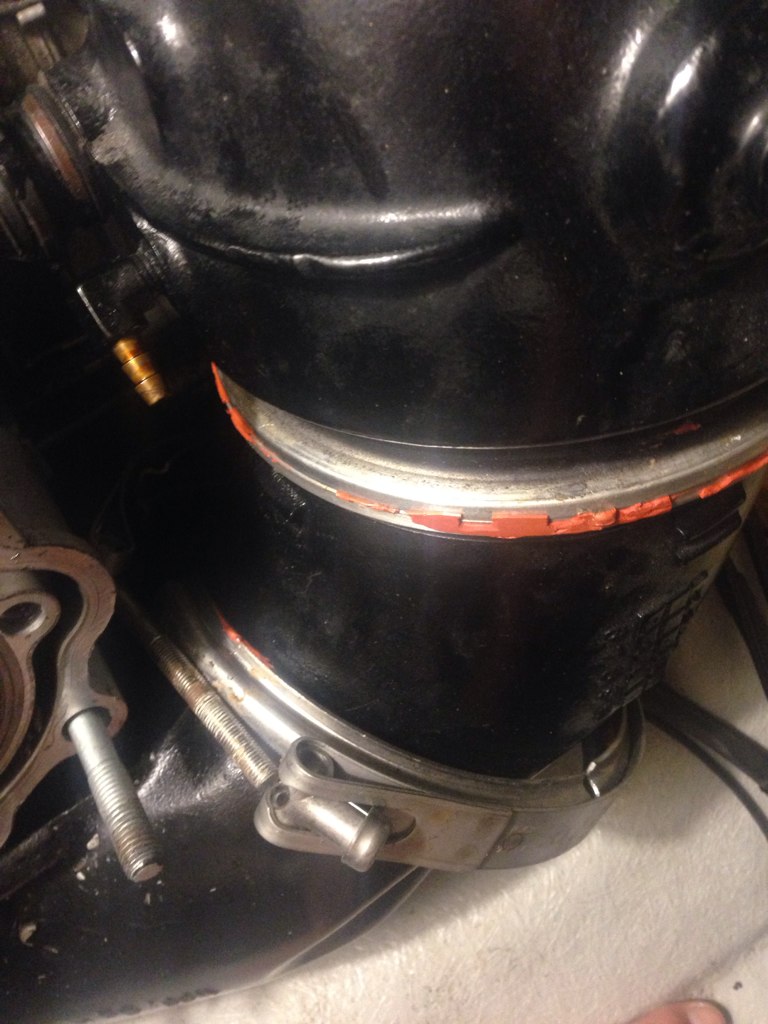

Take a red grease marker and scribe a couple alignment marks on them before separating them
Ok. The clamping ring but is out, but the ring is still stuck there.
