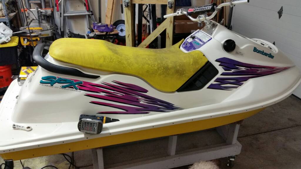

RESTO 1997 SPX "Titanic" Build

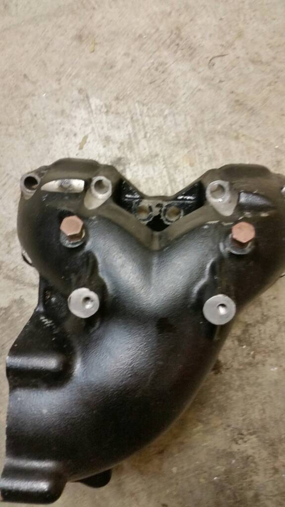

The Factory exhaust manifold I have already has 2 holes tapped and currently plugged. Are these close enough for the EGT sensors or do I need to drill/tap new ones? Location isn't ideal with the current holes.
Any thoughts on this?? I'd prefer not to drill more holes if I don't absolutely have to. I'm afraid when the sensors are installed they may be in the way of everything in this location but will give it a try. These holes are all the way through the mani.
The EGT arrives this week so will be able to install this weekend.

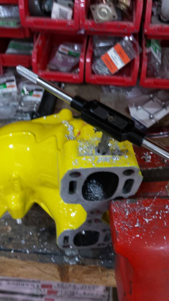

Matts going to be the best on this. He told me to cut the tabs off on the side od the stock one and go right in the middle...

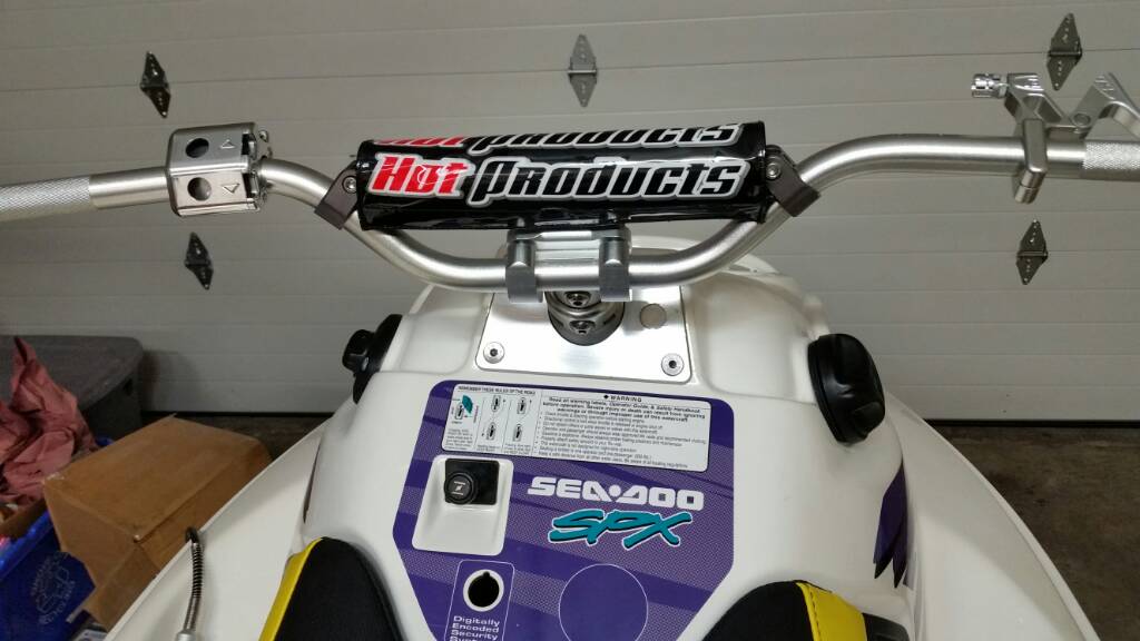

Thanks! I may end up doing the same depending on test fit this weekend. Nice work on the sponsons btw. I also saw a bilge pump in your last pic did you go manual or automatic? I couldn't decide and ended up with a manual pump with the hot products handlebar switch.
Thanks man. I also went with a manual pump. My switch will be on the dash tho. I'll post a pic when I get back home
Why not do both? I've got an auto Rule 500. Just made my own waterproof 3 way switch, and tapped it in next to my primer. Can leave it on Auto when in the marina overnight, or leave it set to off when on the land.
It senses for water every 2.5 mins. Hence why leaving it in auto drains the battery. Better than a float switch which would flap in the chop.
Good point, I may end up doing that. I have the 3 way switch on my boat but had to make the switch setup similar to what u have.
I would likely wire an auto switch somewhere under the seat and the manual on/off on the handlebars in case I got in trouble. I only leave my ski in the water 1-2 times a year, so I don't need it to be convenient to access. The hot products switch and billet handlebar mount is pretty nice so definitely want to use it.

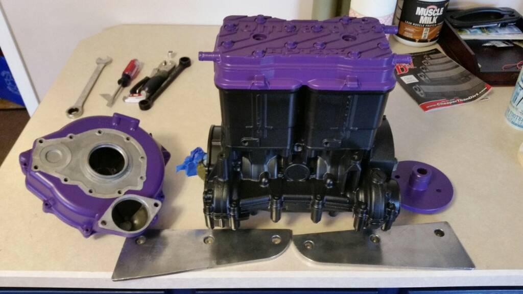

Took advantage of the 60 degree weather and got the engine, pipe, etc all prepped and painted. Was gonna go with black/yellow, but couldn't bring myself to paint anything in steelers colors.

Also, just use those EGT points. Thats where mine are located and my temps are very similar to what I saw on braleys GSX in the other mounting location.
Thats the old 96 style. I have updated ones available.
Thanks Nick. Can you add those to my tab and let me know cost?

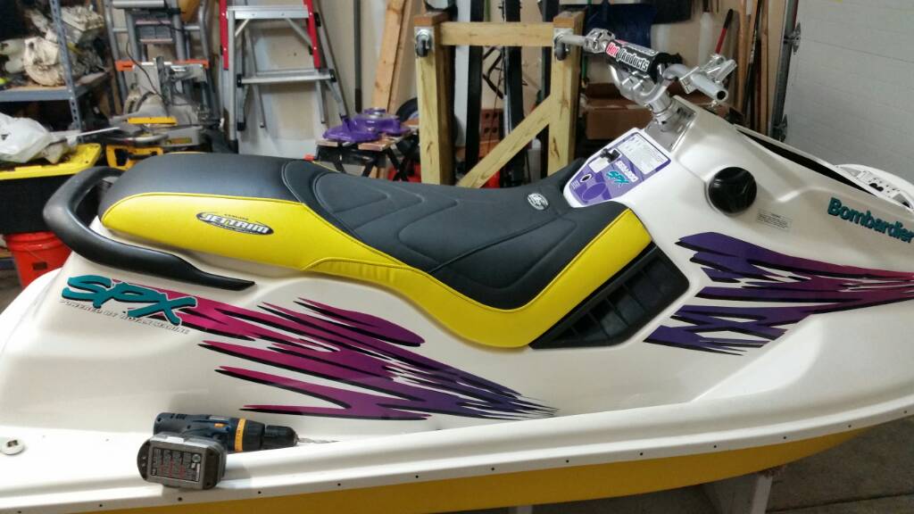

Only had a few hours Sunday to work on the ski. I did get the UMI mounted and started mocking up the bars. I'm waiting to drill holes for the cables until I've got everything mounted. I know I'm going to either need to enlarge the existing hole or cut an additional on the opposite side. There are a lot of wires coming out of the Koso.
I also got the Jettrim cover on. Looks good other than a few small wrinkles I struggled to get out in the middle side.
