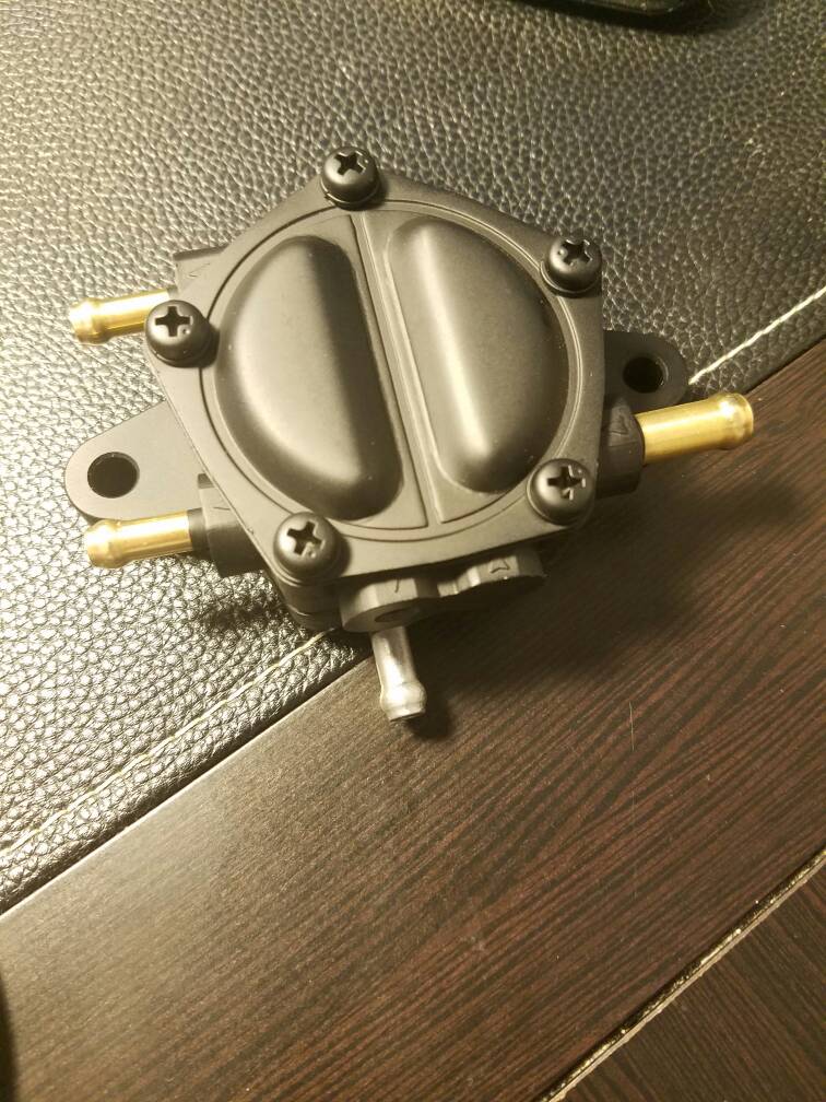

Ok I just got my fuel pump today and it has a 5/16 inlet and 1/4 outlets. Do I need to run 5/16 or can I get by with narrowing to 1/4 since I'm only running Novi 44s?

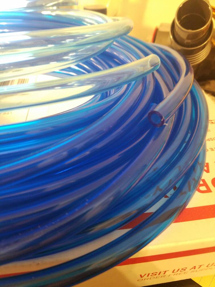

I only ordered the transparent blue fuel line from www.fuel-line.com in 1/4, so would need to order the 5/16. Not a big issue but I'm more concerned about the fuel baffle since it's 1/4 only.

Is there any requirement on fuel pump positioning to in relation to the carbs? Same height, high low, max distance etc?
I did also order a jet kit from OSD. Decent deal, you buy their $8 organizer and pick 10-18 jets and they give you 40% off of them.
Keep the impulse line as short as you can and don't use that soft, thin walled hose for impulse. Mount the pump independent from the engine cause the vibration can mess with it (so the racers say I have not found that to be the case but I usually stay under 7300rpm and some racers push 8K). Other then that it's up to you. It will do it's thing mounted in any direction.

This fuel line actually has a much thicker wall than any other transparent I've seen. I'll still use the blue reinforced I got from McMaster carr for the pulse though.

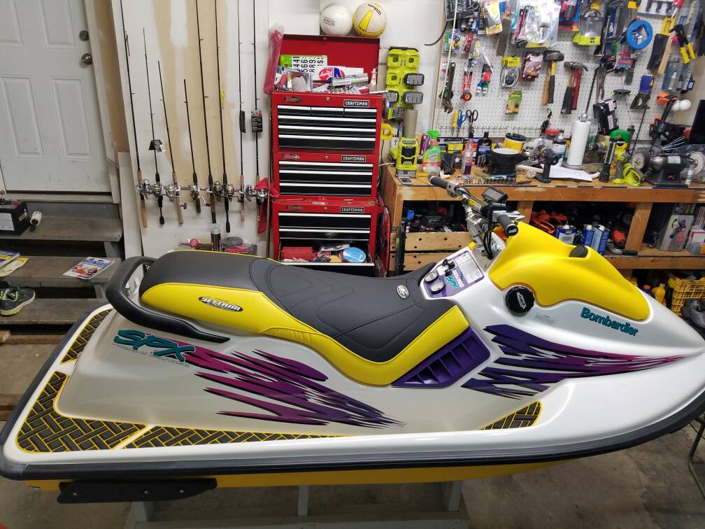

After snowing sideways yesterday it was 55 and sunny today so the SPX got a bath and new mats installed.
Really digging the new mats though!
What kind of mats are those? Blacktip without a logo or joint in the footwell?
Yes, the blacktip elite mats are not 2 piece in the footwell like the regular ones. They did cut the spot for the logo but left the mat material there in case you don't want a logo. Really like them but don't think I'd pay full price. Definitely worth it for blackfriday prices.
Is that a genuine yellow hood?
Yes, genuine mint 95 XP800 hood.
