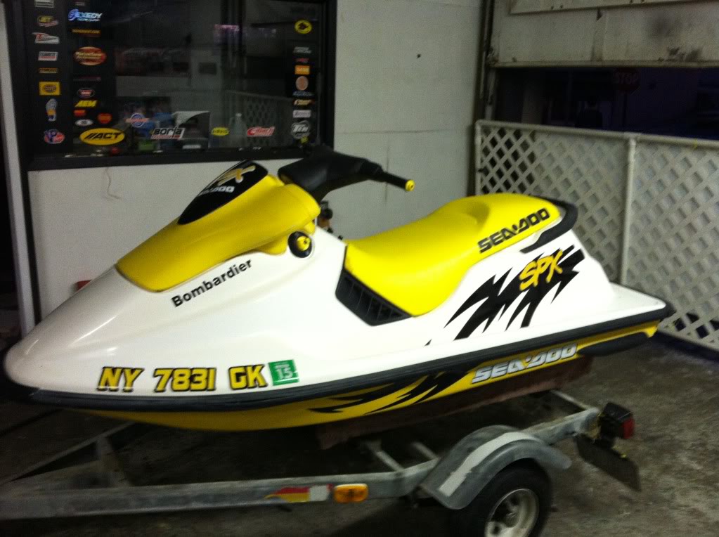

I don't have that much time to run a thread... I love them though! I have been following all of them on here!! I have done a lot of work to it. I have never rode it YET... I did put in a new prop and wear ring, rebuild carbs, change fuel lines, change oil filter and oil. Now runnin xps2. Put on a new head pipe because of leak on weld. Fuel guage and vts work! Got a new AGM battery for it. The seat is a hump seat from a 95 Xp 800. Some guy walked in my shop with it and I freaked and bought it. Problem is I did not even have the ski yet! So I had to buy the ski for the seat! Lol hey stovetop this is to give you some inspiration!!! ;)
Ok just wanted to show you my new to 97 spx. I do all the work myself and its almost ready!!!
Wow!! that thing is so clean!!! I really like it man!:thumbsup:

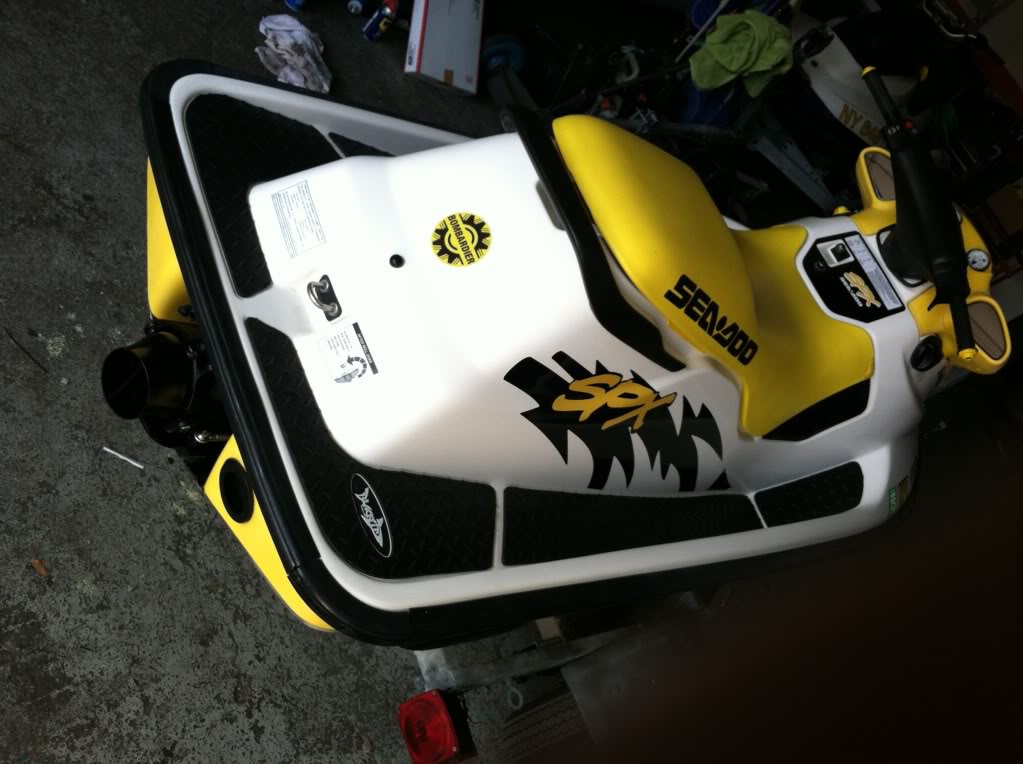

Great job on the seat! It looks great. I don't mean to high jack you thread but since we are workin on same ski just want to show you how my ski is comin along. I just finished puttin on a fresh set of blacktip mats. Not bad for 40 bucks!!!
No worries, post away!!! U might wanna start your own thread just so people really know its your boat and u get all the credit, but hey more views on my thread make me feel more popular haha:thumbsup:
Man you boat looks so cool!!! I'm still trying to figure out what to do with the rest of mine cosmetically, yours makes me wanna go with the yellow, white and black route for sure!!! Once I figure out the what im going to do with the hull, I've got black tip mats to install as well!
