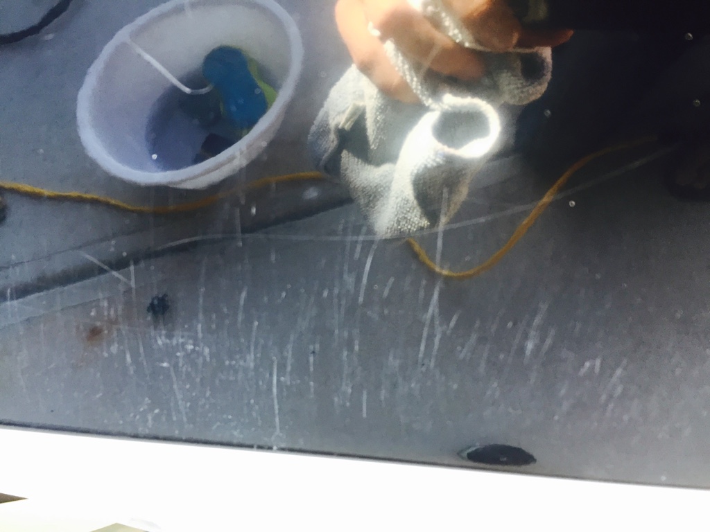

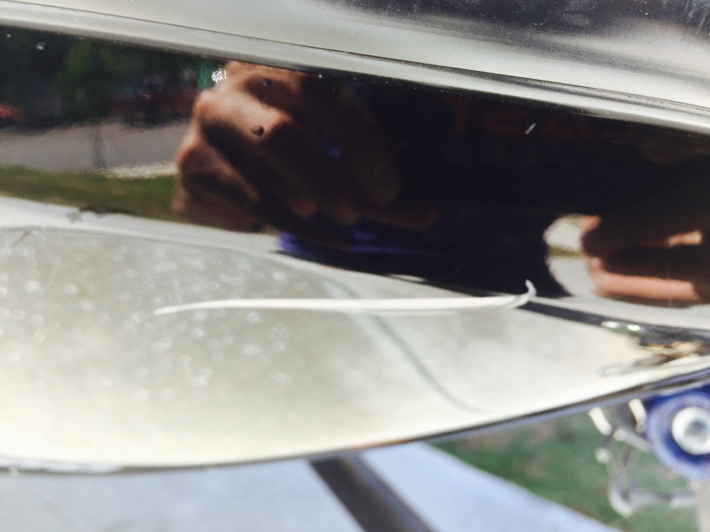

Cleaning up
before
http://images.tapatalk-cdn.com/15/05/23/e7f963775c6010ee2e7790cac6478b8d.jpg[bIMG]after
[IMG]http://images.tapatalk-cdn.com/15/05/23/cb4f77ae0d2fb8f66b20ceedc1a59673.jpg
Wow! That looked really good. That is some serious effort, there.
