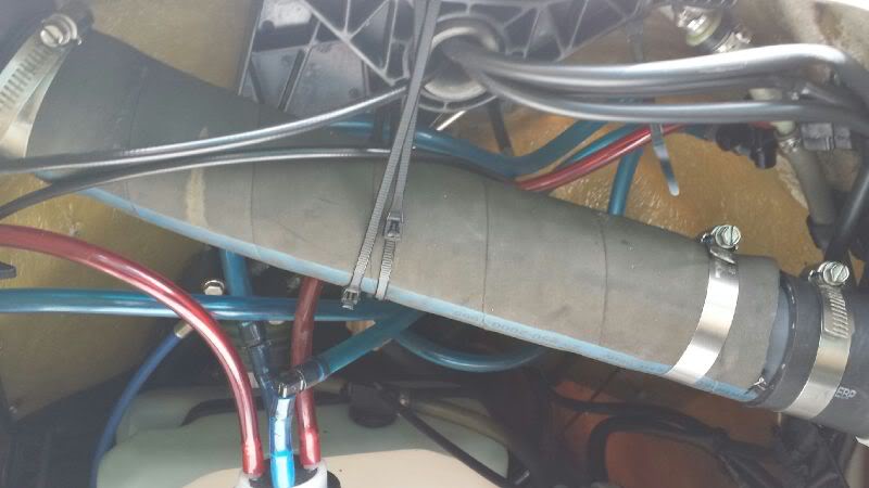

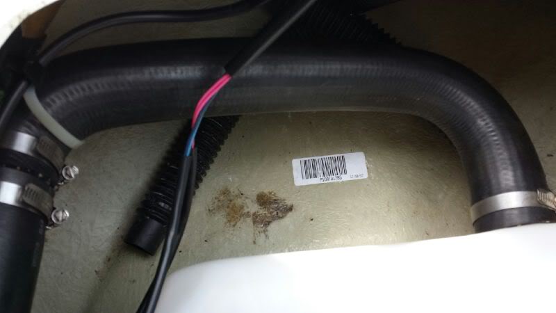

12 gallon tank installation
New 12 gallon tank and a new gti baffle, to replace the x4 9 gallon tank.
Installed
Rj used hoses we had from part outs to loop the hoses around the tank and made sure to have the hoses on an downward pitch, the pitch is important if it doesnt have a nice flow the fuel will back out the fill tube.

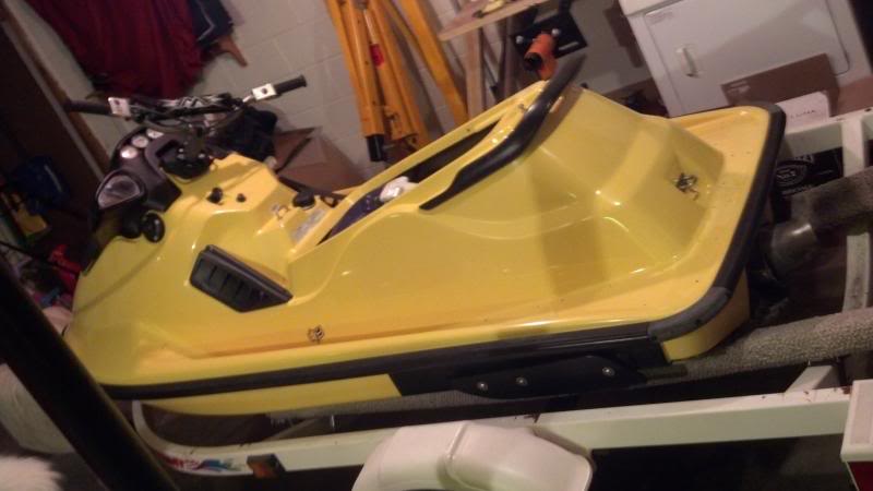

Well I decided it was time to strip the the ol' XP down and buff it out..
After buffing and new grips
Single gauge hood is being painted hopefully will be done in the next few weeks. All I have left is to install my new seat cover, mats and get another offical Cult graphic
