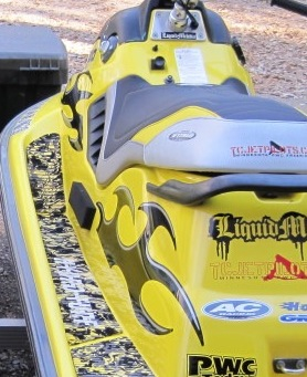

Anyone wanna buy two clean X4s? Looking to sell mine....
Lots of goodies on the XP, UMI steering not pictures but has it now.

Any x-4 guys want to help me out?
I am looking for a small amount (scraps) of traction mat to guard my ankles against the side of the footwells while jumping waves. Anyone have some to sell?
I currently have black tip mats but need something for the inside of the footwell.
Edit:
This is what I am taking about (sort of)
