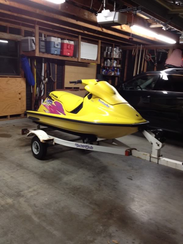

Picked up my First X4 in April, just read all 50 pages of this thread and figured i would post up a pic of my 1996 Xp. When i picked it up.
Dont mind the trailer lol
On a technical note, it was leaking from the water regulator so i took it apart and cleaned it, there are no holes in the bellow, but does anyone know how far the screw that goes from the bottom side is suppossed to be tightened down? snug?
