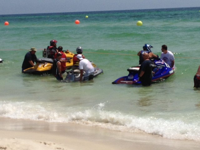

Thanks for looking into it. Here is a pic of me on the line a few years ago with Rob to the right of me. My X4 had been painted silver since Rob owned it so I yelled over at him "hey this is your old ski" and he said "my old skis are like my old girlfriends... you don't want them when I'm done with them. lol
