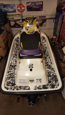

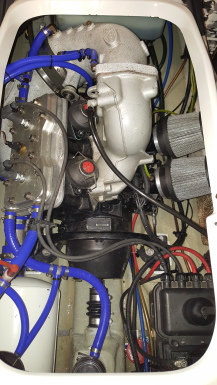

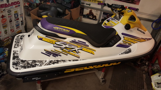

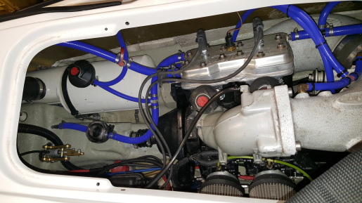

If you are part of the Seadoo owners page on FB you may have seen that I picked up a 98 SPX about a month ago. Supposedly ready to roll....needed EVERYTHING. Well here is the outcome....

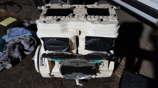

And if that wasnt enough...here is a 787X motor I just finally got back together. Its got the original cylinders at original bore, with new OEM pistons, all OEM seals/gaskets, New oem bearings on the CB and RV. This is all original 100% 95 787x parts, I didnt have to swap out anything (Dan should love that!!) The motor had two bearings on the mag end rusty, my crank guy replaced those and gave the rest of the crank a good bill of health.
I might be coaxed into selling it....I do still have the machine it came out of but its not perfect like I would like to have it to justify a restore. Hell if someone wants to buy the whole setup and do it the way it should considering how hard it is to find a numbers matching 95 XP 787x machine I'd love to sell it to a good home.

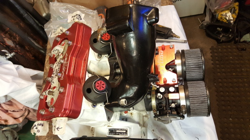

And last but not least...I am FINALLY putting together my 920 miller boat. Cannot wait to fire this puppy up next week. Going in my black hull. Brand spanking new Novi 46s, port matched intake, brand new flywheel, brand new OEM starter....stay tuned!

Nick, where did you get the blue hoses? I've been looking for some. Thanks

[MENTION=57566]thomps33[/MENTION] its a Westside exclusive. Had to buy 100' at a time with a business account. Its roughly $2/ft depending on diameter. Got it in 1/2, 3/8, and 1/4.
Ahhh, Thanks Tonka. Was hoping you had a better hook-up than that locally. FYI, when Zoro has its flash sale you can get the 1/2" for 1.40/ft, 3/8" for 1.25/ft, and the 1/4" for about .90/ft if you need more in the future. It's the good silicone hose made by Flextech that's rated up to 350 degrees.
