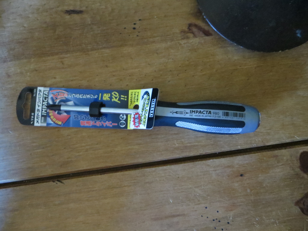

I dont remember which thread I read about these things for removing the stubborn JIS screws from the carbs. I really dont think I could have got them out without it they were in there so hard. It also extracted a partially stripped screw that someone had already attempted to remove at some point and gave up on, thankfully before destroying the screw completely. Highly recommended tool the Vessel Impacta 980 (P2x100 #2), a nice addition to the tool box. Gave them some nice wacks with a 3lb sledge and it broke them loose.
That's a cool product. Usually have good luck with a blowtorch but I'd be willing to try this.

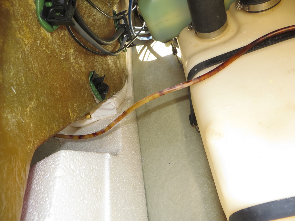

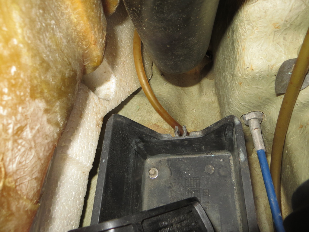

What is this hose for? It vents on the starboard side and the hose ran to the back on that side to just behind the battery tray and was hooked up to nothing. Also had a big hole warn or burnt in the hose halfway through its length.
Vents here
Hole burned or dry rotted through here
Back end was just sitting back here
