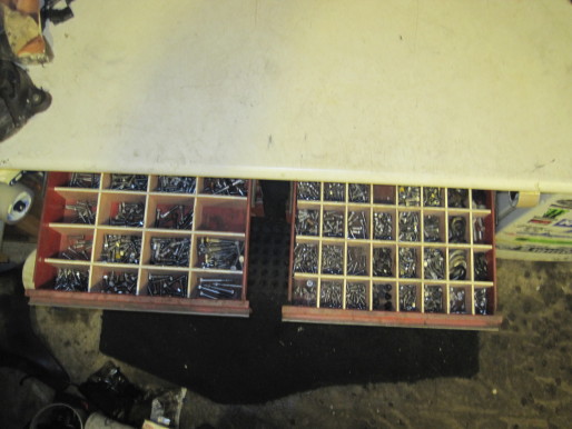

I have all types of hardware seadoo related sorted including complete engine bolt sets bagged up in ziplocks. I also have new SS lock washers to replace the crushed ones to fit 10, 13, 17MM bolts.
On small stuff it is free with purchase, larger bolts I charge a minimal fee.
The picture below was the day I started...they are heaping now.
