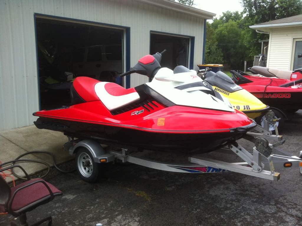

IMO, rebuild, you already have it apart ! and you can find good cranks for 787's reasonable (i'll check, but I don't think i have one with ALl good bearings, i might have one with a bad outer....) but finding a good 787 crank/new or used to put back in would be my suggestion.
or if nothing else, if you want to go that route (sbt), give sbt a crap core all locked up, don't give them a good head/top end/clean cases out of the deal, you want to give them the real sh1t parts.
I do agree but if I rebuild it I would want to have the case mod done for the counter shaft and one of my oil ports broke of so I'd have to extract those threads and get new crank and one of my cylinders is cracked and jb welded (by previous owner) and then I wouldn't have any kind I warranty on it. I think my best bet is to go with an sbt. And then I don't have to worry about the cases sealing right
