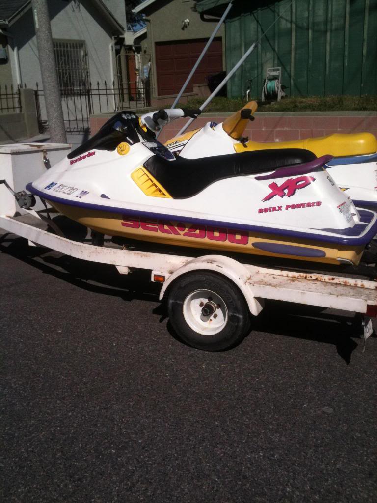

The XP is running pretty well and so is the tigershark but I took it out yesterday and when I was launching, this guy with a 100 year old pro-line was staring at my boats and shaking his head in disapproval.! His boat looked terrible. Never again. This is what it looks like now but not for long. Only problem in my opinion is that the purple is everywhere. Bumpers, hydroturf and sponsons are so expensive and I want them gone. Any advice on cleaning it up a little bit would be appreciated.
Honestly, Im not really digging the black. You got black, purple, yellow, pink and white. Its hard to make those match, I would get rid of the black and go back to the stock look if you can...
Thanks for the honest opinion. I'm too far gone to turn around now. Just keep on painting... I have a handlebar pad and hood cover from an gtx or something. Painting it Black and the pad upholster to grey. I was thinking about changing the decal colors to black and painting the gas cap and side vents grey. Also have grey hockey tape for the grab bar. Evntually I want the black marble hydroturf and the black bumpers. But that's a lot of money. Soons hopefully.

In my opinion it would look better with the decals taken off, like ocod's. I would leave the vents and gas cap yellow and paint the grab bar yellow, I think it would look nice with some yellow up top with all the yellow on the bottom. Do the trim, and turf when you get money. Oh and paint the sponsons black. Again just my opinion, looks like you got a good start :thumbsup:
Actually like that idea youcandooit. The handlebar pad is already yellow and the handlebar cover is painted gloss black so that should add a little more yellow to the top. Definitely getting rid of all the pink and purple when the time comes. paint the sponsons in place or take them out and paint? seems like a pain to take off.
