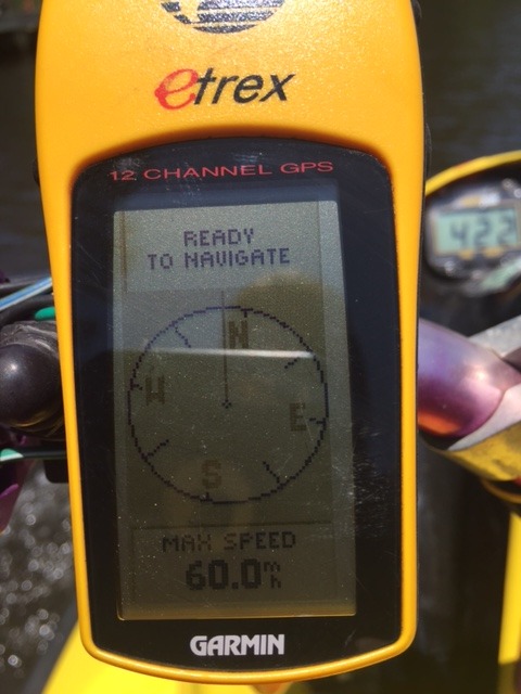

It liked this pump and nozzle set better. I also advanced the timing another degree and enlarged the stinger jet from 160 to 182.5. Now it revs up to it's potential every time, unfortunately it's potential seems to be 7K ish. The rpm reding seems to jump around a little so I'm going to bring a TTO next time to check against the Hot Tach and make sure I'm getting an accurate read.
