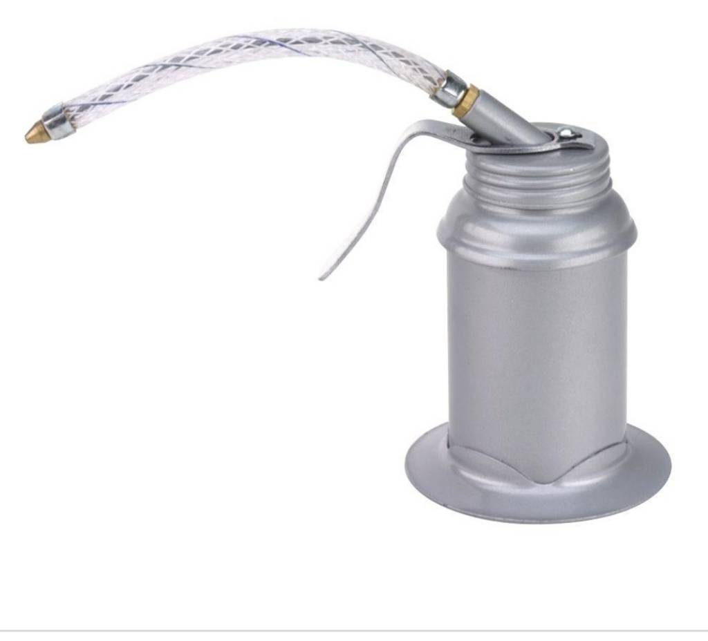

So, you take a can like this. Fill it with atf, put the nozzle in the internal ports (see mikuni side cut drawing for port flow) and squirt. You'll see exactly where the red fluid flows, like those little micro holes in the carb throat. It's a actual visual confirmation that you have flow going thru all the ports. It's very, very simple. It has never failed me.
