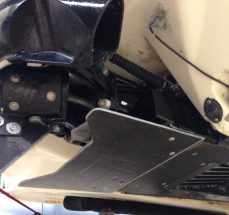

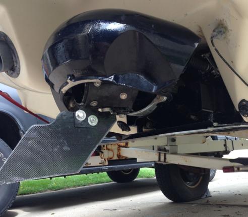

For those who have the stuck or stripped bolts on your factory plate, here's another option as what I did. I have a 2003 SeaDoo Utopia with the Mercury 240EFI engine and M2 Jet Drive.
I do a lot of hobby work with Carbon Fiber, so I'm pretty comfortable making pieces that are more than strong enough out of it. I went with Carbon because it's a LOT LOT lighter than any steel or even Aluminum equivalent ideas that have been made on here and the stuff I made for this will flex a small amount but always return to the original shape. So think when the boat takes off, you want it to pitch a little but then the plate pushes back down to level it out.

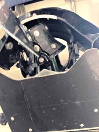

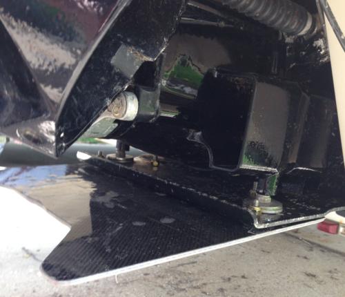

I made basically an "extension" plate that I drilled 4 holes in my factory plate and mounted it. There's more than enough material there, the original plate has 13"x4" sticking out that you can use as the mounting section for your extension plate. I also beveled the leading edge so there's next to no water resistance. The 2 bolts towards the stern have washers between the CF plate and the factory ride plate to be able to adjust the angle. Currently with about a 3/16" amount of washers, the boat works perfectly with no porpoising and rides awesome even with 3 people on the rear seats with no one upfront.
I also shaped the plate with a little different outline to provide as much ride plane help without interfering with the nozzle at all.
And you can partly see the other piece I've made - a rudder out of Carbon that attaches to the nozzle itself. I wanted something that steered a little better and didn't have the tendencies to drift as much when moving. It also gives you a tremendous amount more steering at slower speeds. I'm still tweaking the shape of it for the best performance.
All of these parts have been through at least 4 hours of running now with no issues. I think I even smacked the rudder into the bottom once already with no damage on a hard take off in shallow water, so they're very durable.
I've also noticed zero loss in top speed - actually may have gained .5 or 1 mph.
