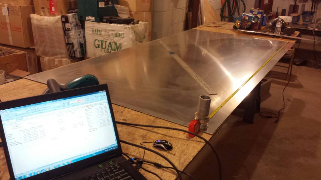

Finally back at it. Wifey is back home visiting family, so I'm free to build the fuel tank. I've been practicing all weekend using the rail saw, bending, and welding. It's been a while since I've done this, but results are looking promising. This Makita rail saw is a beauty. My new favorite tool! I'm getting cuts accurate down to a mm.
I'm going to err on the side of caution and overbuild this thing. I'm not playing around with gasoline!
My plan is to bend the entire bottom piece, excluding the bottom troth. Going to build and weld that on later. Including that is going to make bending the bottom EVEN MORE complicated. It's ambitious enough as is, and a bad bend results in other dimensions getting screwed up. It all builds on itself. Measuring 17x, cutting once, bending once [emoji106]
Got the bottom piece cut out and measured. Tomorrow I'll do the scoring cuts (to bend along), then cut out the rest of the pieces.
