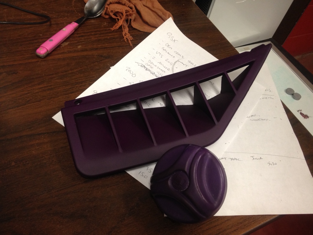

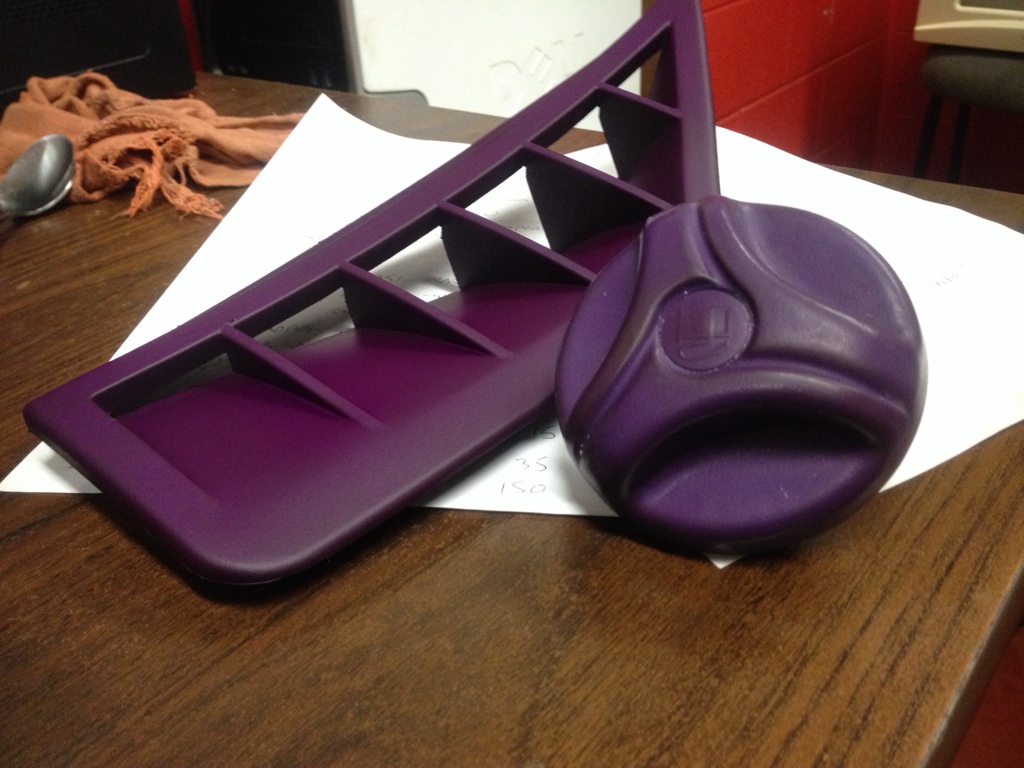

I'm trying purple 'blaze' plasti-dip on the seat vents and grab handle right now... I didn't spray a white 'primer' first, I think having the black underneath will help get the darker colour to match the hood. Shoulda grabbed a GSXL fuel knob and bezel from Nick... DOH. Was toying with changing the bumper 'inserts' to GSXL inserts too... We'll see.. Wish the bottom was white... I'd do a 95 SPi replica ;)
Thanks for posting that I was considering purple for my hood as well. I may stick with black or yellow though since I'm not painting the bottom.
I may need to pull the purple inserts off my HX and see what it looks like. I know I saw someone's 96xp with all purple bumpers and it looked good.
