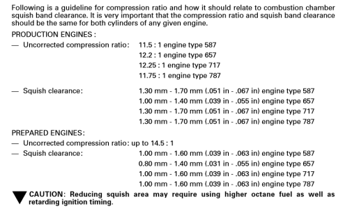

I wanted to post this, after all the squish talk I went back and read some things...and #1 Harry never went over his preferred squish, he was more into preaching the 170psi and talked about the variation in pistons and assembly factors.
Here is what I found in the race manual:
That's some good info nick, thanks for pointing this out.

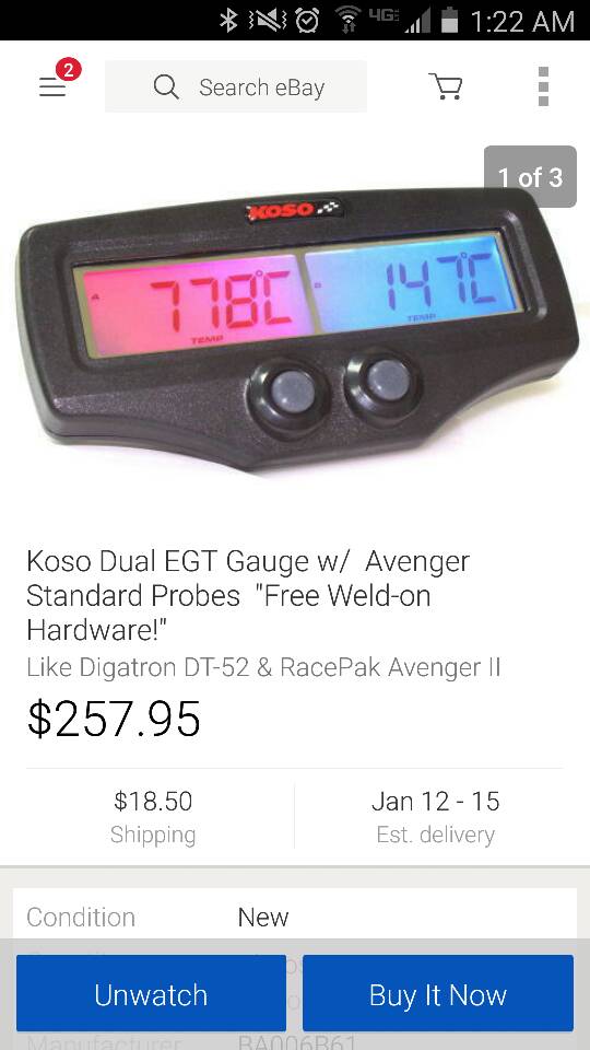

Got some question, has any one ever used one of these on your ski? After doing some reading I think it might be a good idea to know my exhaust temperature. Just to make sure I'm on the safe side

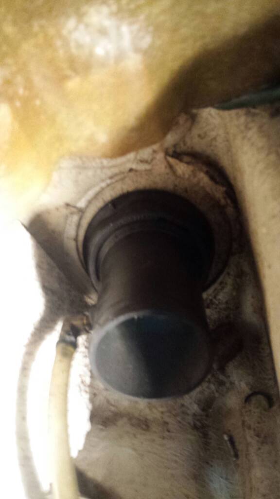

What's the best way to get this off?

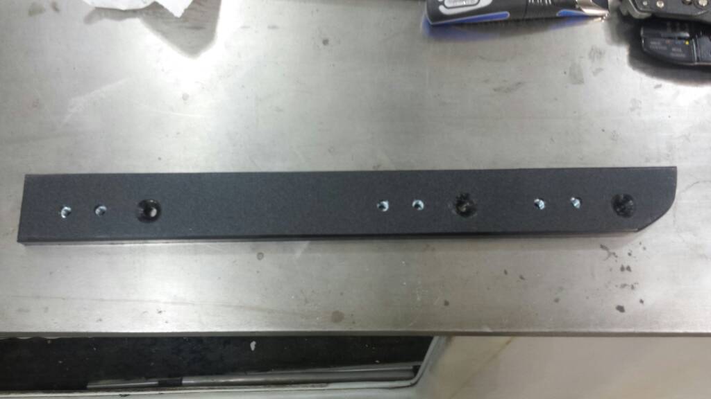

I did get some work done tonight. I got the ski stripped down and flipped and started to buff the bottom. Also finished up my backing plate for the sponsons.
Nice work on the sponsons the look original for sure.
Ive never seen anyone use the Koso Gauge, Id be interested in seeing it work. Just FYI, the Hot Tachs had all sorts of issues. water wise too. People sent them in for repair all the time.
As far as the tool to get the outlet out...I will post it in my thread. I feel dumb for not pointing that out.
The exhaust outlet nut on my 96 wasn't very tight at all. I forget how I ended up getting it off and on, but I've heard you can make a 'socket' by heating up a piece of appropriately sized ABS drain pipe and sliding it over the nut and letting it cool. Follow the wires for the VTS Into the top connector and through the bottom connector. I want to say the bottom one is VTS but ???

Where did you put your sensors at on the exhaust? Got a pic?
It's cheaper to buy and install one than replace a topend
