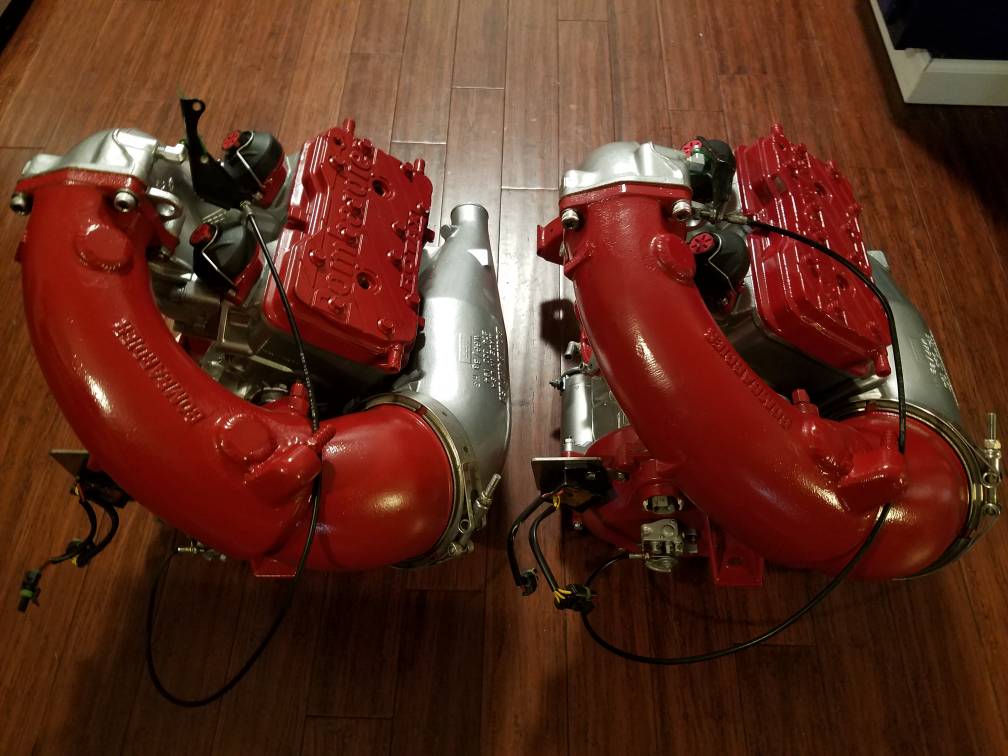

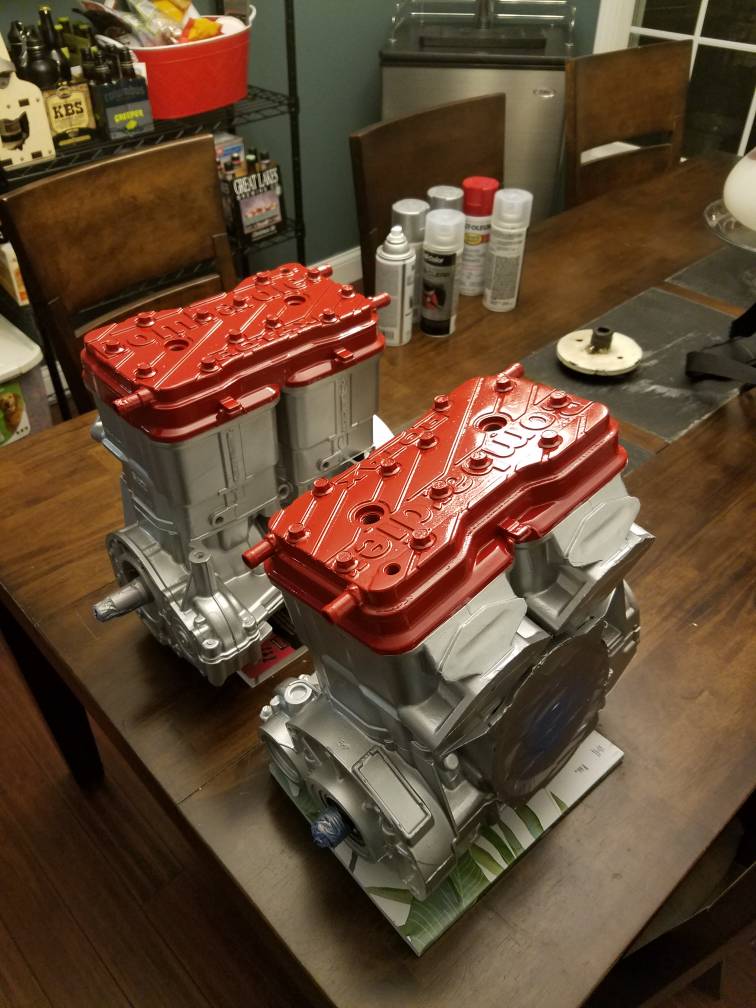

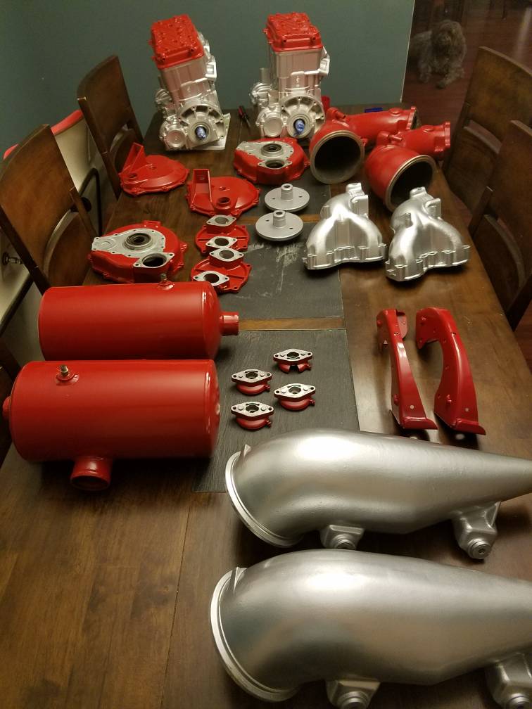

Just a small update on progress. I got the engines painted and started cleaning up mag housings, raves, etc for paint so I can finish assembly. The wife is very happy when I leave the engines on the dining room table for the paint to cure while I'm in Tx for work lol. Spray paint is super slow to cure in a 40 degree garage.
Just ordered over $1k in parts last night to get everything back together. This thing will be essentially new from a mechanical standpoint.

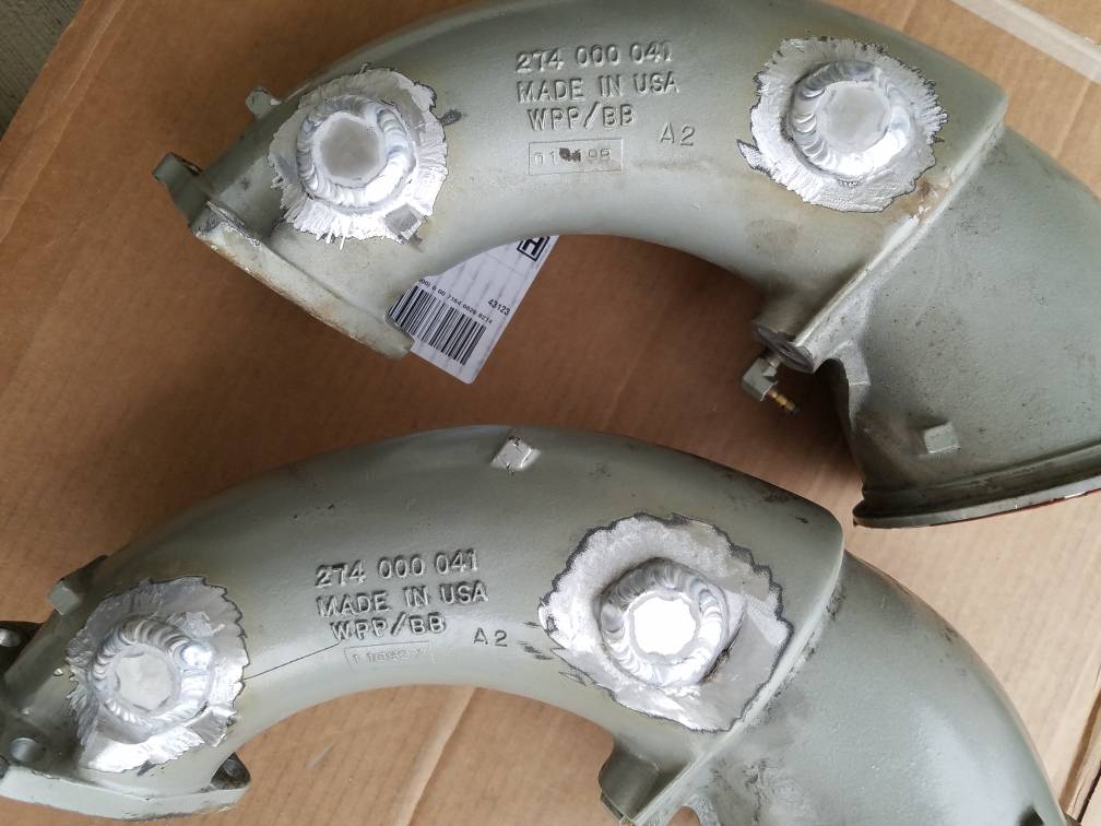

I finally got my pipes back from the 2nd shop I took them to today. Somehow they claim it took them 2 hours at $75 an hour plus shop supplies to weld 8 plugs. This was after i ground all the old plugs out and privided the new plugs. I'll be having some words with them tomorrow when someone besides the receptionist is there.

I just had mine done today. 40$ for 4 plugs.

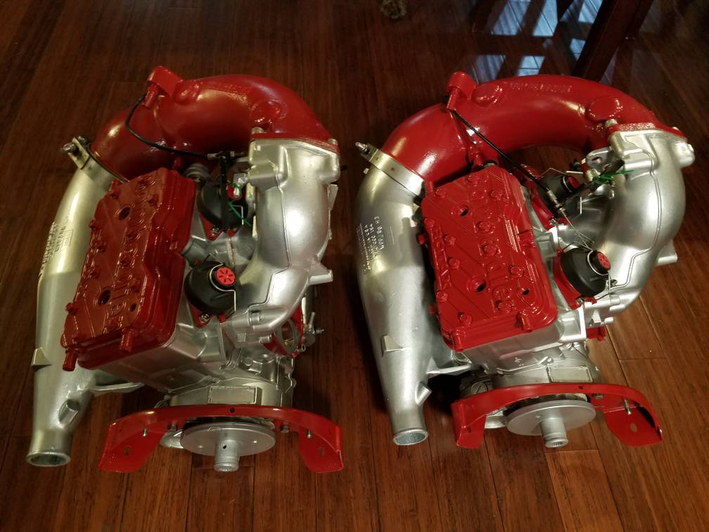

This weekend I finished stripping, cleaning, painting, and clear coating all the engine components. I swear that is the worst part of any rebuild for me. Took a solid 3 days since I don't have a blast cabinet.

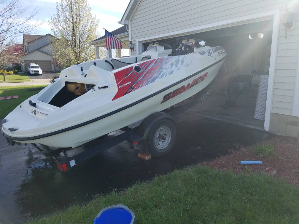

I also got the boat out to give it another bath and pressure wash the engine bay one more time.

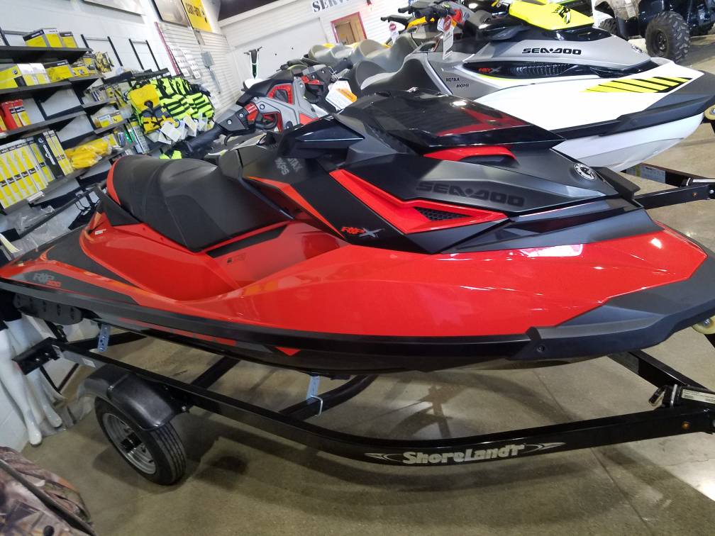

Also bought one other accessory today, lol.
Yeah yeah, I hear ya. In my defense I did wear an early 90s seadoo vest today for break in lol. This thing could be a major distraction for me finishing the speedster.
Lol, that life jacket is rated at like 35mph when it was new. Then factor in the dry rotted threads and you're rated at like 7mph.
Lol, well it's the only one I could find in the attic that fit. All my good jackets are still with the boat in storage. I'm not getting over 30mph much today anyways for break in.

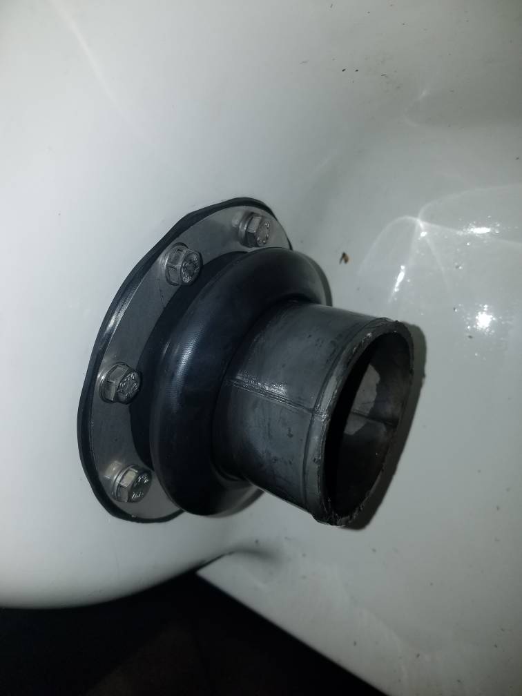

New Exhaust boots from Nick who had them reproduced once Sea-doo stopped making them years ago. My old ones were only slightly dry rotted, but I didn’t want to risk taking on water after all the work that’s gone into this thing thus far. A ratcheting 10mm wrench with a flex-head made it relatively simple to replace these from the outside of the boat.
After many issues, I finally have the engines ready to drop in. I had to remove and replace 2 heli-coils in the RV covers, then I had one bolt snap off on the rear engine mount. After ordering 2 different extractor sets, it was clear that bolt wasn’t coming out. I finally drilled it out, then when going slightly larger to prepare to re-tap the freaking drill bit snapped off about 1.5 inches in. There was no way of removing that bit, so one engine is just going to have 4 bolts instead of 5 on the rear mount. I have to say that I do think they came out pretty sweet.

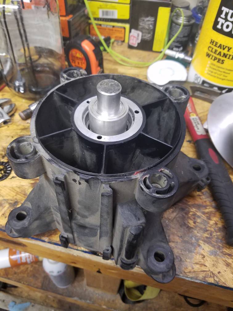

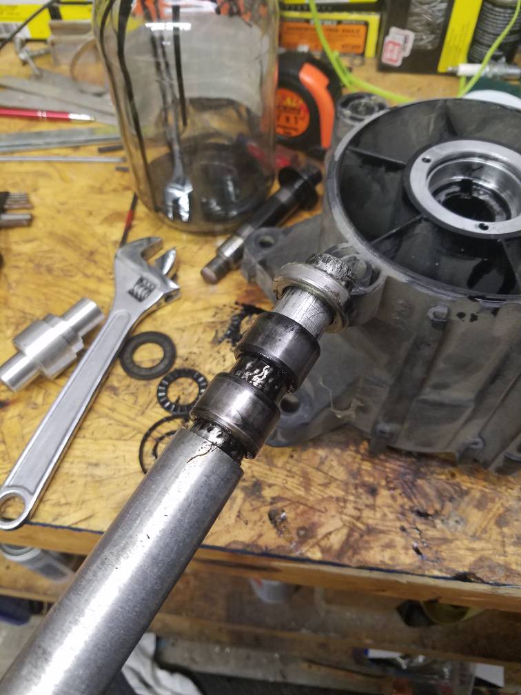

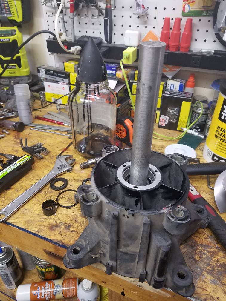

I had thought both jet pumps/wear rings were in good shape, but the oil was lumpy and there were some small out of round gaps in the wear rings. I started full rebuilds of both pumps tonight. One completely done and the other need to order another bearing kit & wear ring.
I still love this bearing tool set a member here makes. You can change bearings in 5 minutes with no shop press needed.

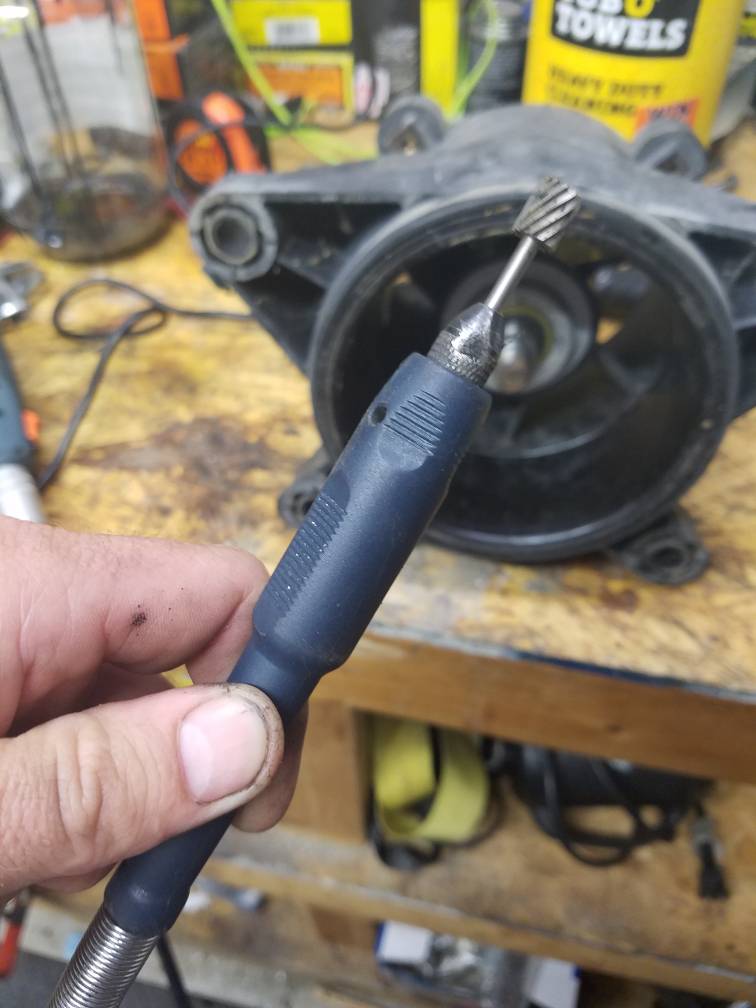

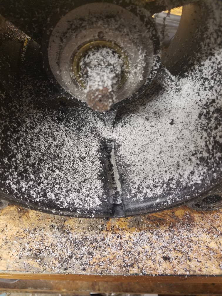

I know everyone has their choice for wear ring removal but my favorite is this bit on a Dremel with the flex cable. It easily cuts a wide path through the ring in no time and the ring will collapse on itself and fall out.

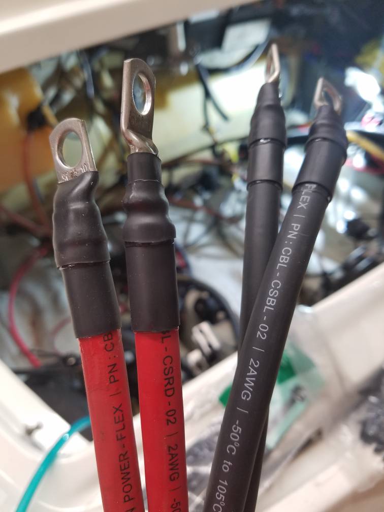

I made some progress over the weekend.
I made new battery cables for the 2nd battery which will connect through a new 2 battery switch in place of the single one there now. 2 gauge was a bit of overkill but I figured it's 10' of cable between the battery and new switch.
