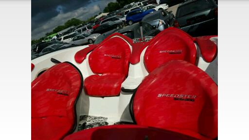

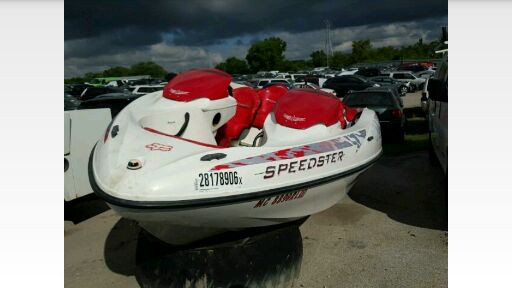

Well I was the high bidder on another 98 speedster at an auto auction to have some spare parts. Bid didn't meet reserve so they have till Monday to accept.
Well if this goes through one will get parted and dumped. Seats for these things go for 200 each seat half. It's nuts.
Well so much for the parts boat. The place relisted it for what will be about 2500 buy it now after fees. Not gonna happen, lol.
I'm not missing anything. The interior on this other one was mint while mine is just good. I figured if I got it cheap and mpem worked I'd end up with my boat for free.

I have never seen seat halves "SELL" for $200 for our boats. If they do, it's not on ebay. I always look for spares just in case. There are always red ones for sale, rarely and I mean rarely yellow ones. I used to save every auction on my pc for the seats.

This dude sold each seat half except for 2 bases for 200 shipped at the end of dec/early december.

Wow, that is ridiculous. I've seen tops and bottoms in nicer condition than that sell for the same money.
Yeah I guess it just takes one guy who wants them bad enough. They went within a day of listing too. That was supposed to read late november/early dec.

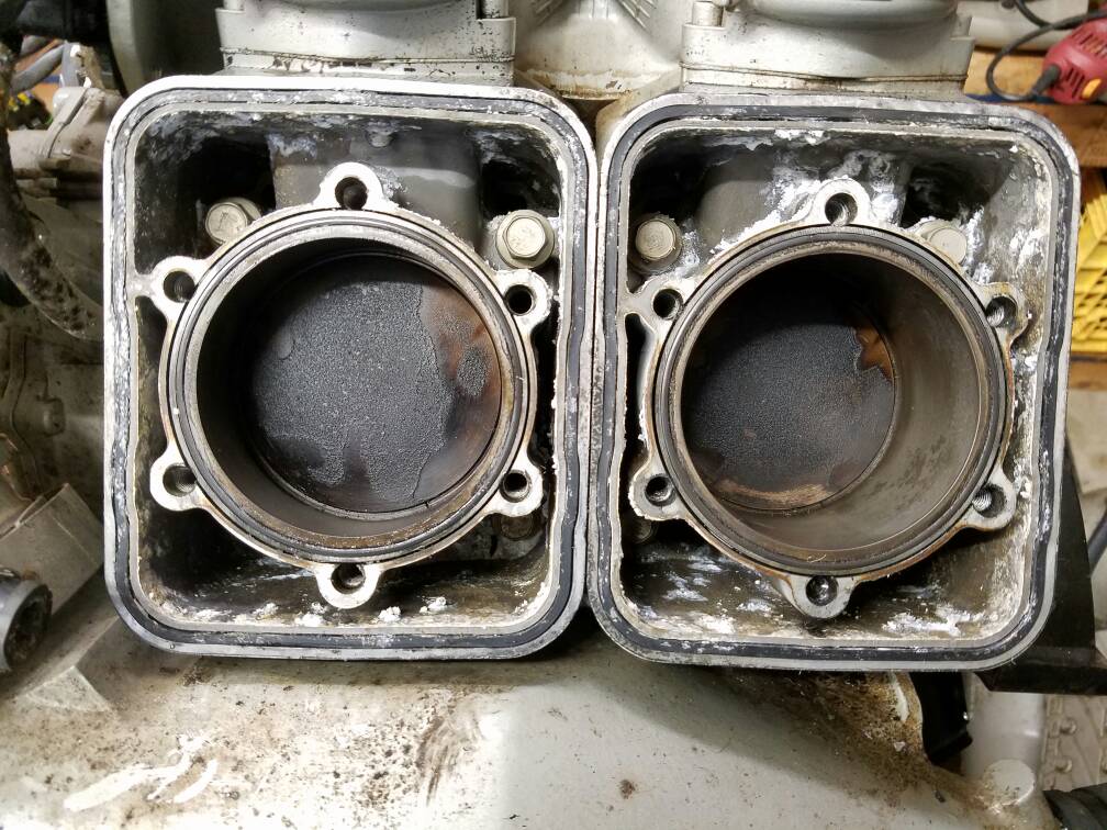

Today I played around with the port engine that was reading 130 psi before I pulled it. It turned over a little slowly in the boat so u swapped a different starter then pulled the head to check things out.
Surprisingly both cylinders looked really good other than some rust on a small area of each cyl that had built up. I got 90% of the rust off with a scotch pad then steel wool. There is absolutely no scoring on either cyl.

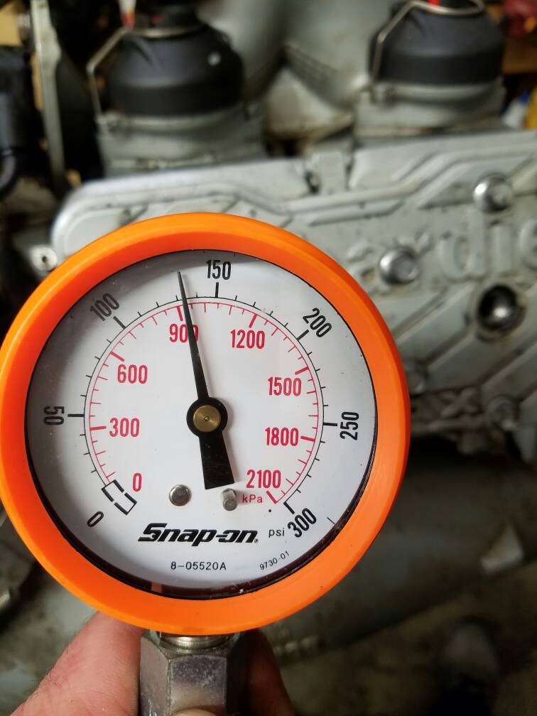

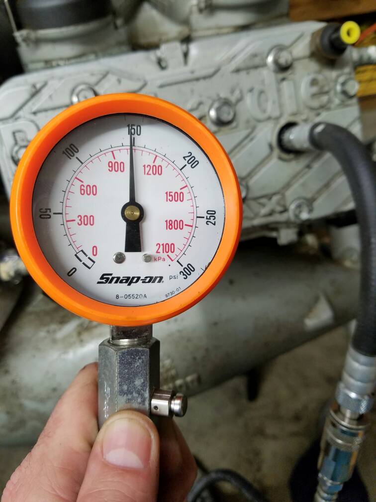

After throwing the head back on ingot to test out my new $70 snap on comp tester from ebay. The thing looks completely unused.
Results were approximately 132/148. I will say I don't like the 10psi intervals of the snap on gauge. The lower of the 2 cyls had the most leftover rust I couldn't get off.
