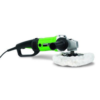

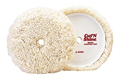

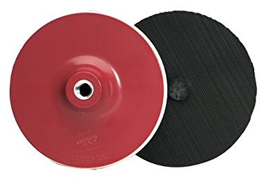

well I`m going to give it a shot! I also spoke with a Buddy who did detailing and these are some of the things I picked up to do the job.
Sooo I started out just wanting to try this and got into it for a couple of hours. Man what a difference already. I didn`t even realize how oxidized the hull was and many many water spots. This should clean her up nicely...
When I`m done I`ll hit it up with a a good wax as well...:cheers:
Nice! :thumbsup:
That wool pad should cut pretty aggressively.
I like to follow the wool with foam buffing and polishing pads. Cutting with the wool takes WAY longer than the follow-up passes.
