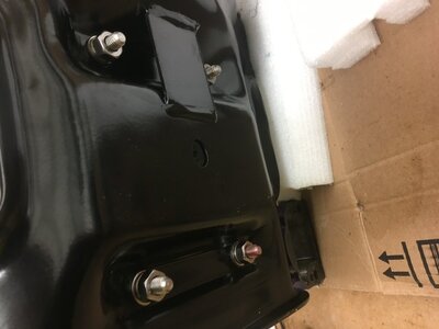

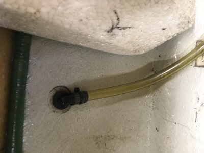

I took this through hull fitting out to change the grommets, while I was at it I decided to clean and blow out the fitting. Something large came out of it. I’m pretty sure this is the pisser, it goes to a T fitting as seen in the picture, the other short hose from the t fitting goes just beneath the exhaust manifold which I believe is an engine drain and then also from the T fitting is a long hose that goes beneath t he engine to the rear of the ski. My question is, that through hull fitting, is it a one way valve or is it just straight through? Not sure if I damaged it or just blew a chunk of dirt out of it. I’m guessing that it is just a straight through fitting not a one way valve but I will see what I can find in the manual

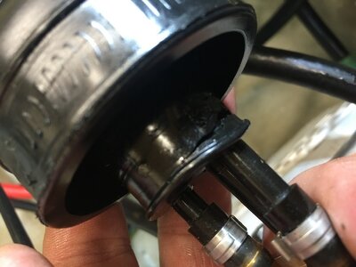

0FC4F43E-6408-426B-A8E3-8752A716705A.jpegI found this crack in what I believe is called the fuel pickup unit? Will it affect anything or would the nipples that the hoses connect to still hold air? I guess I could test them with some pressure

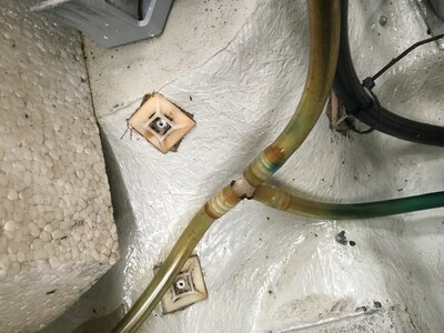

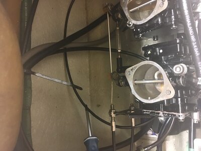

Would it go here?4062CB2E-B604-4187-B625-321C23D8727F.jpeg038B2C91-5FAC-4560-85D9-0985B7D7EBE6.jpegBecause if my computer going down I need to make sure of a few things, this line here goes to the fuel baffle labelled Return

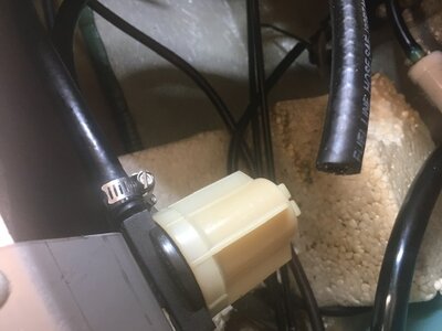

8914BE56-8CCF-4DE0-A172-E0C6105AE8DE.jpegAnd this fuel line comes from the fuel filter. It would go to the fuel inlet on the carb correct? The other line from the fuel filter is going to the fuel Selector valve labelled out
The return line from the baffle is about twice as long as it needs to be to reach and has an L fitting in it? I’m going to leave it like this but the only reason I can see for the additional length is so you have room to tie it out of the way

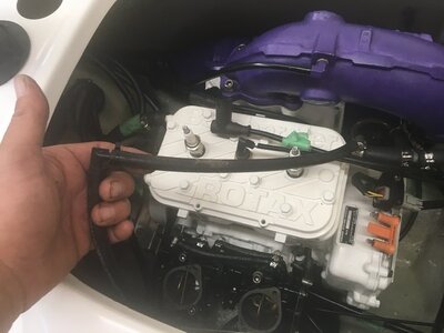

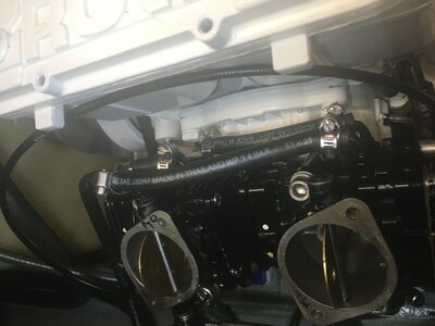

373C5434-6617-4E84-A499-0F8D638819EB.jpegI had a look at my 95 XP and the oil cable was routed so that it would be beneath the flame arrestor, does that seem like the proper place to route that cable?
I am pretty sure it is routed down the side of the hull not over the intake manifold.
Yes, the return line should be routed up with the plastic elbow up, not really sure why they did that.

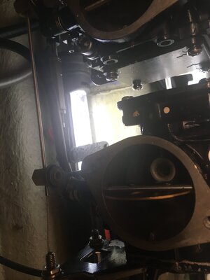

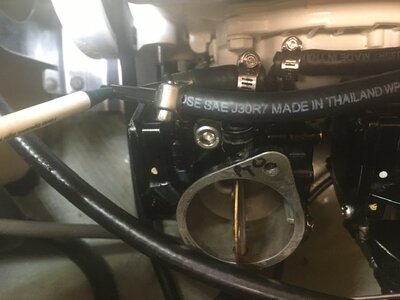

25F97CE5-5657-4FBF-B6D0-55B379FE353A.jpegI found putting my light down there and then just taking a picture with my phone was the best way to see it. Probably a second person looking at it with an inspection mirror would have been easier but...

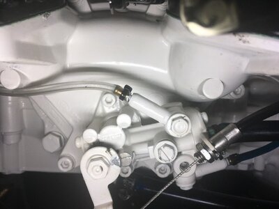

I accidentally unscrewed the screw that the small oil line is attached he’d to when I was bleeding the oil pump, it tightened right back up but would that have caused any issues? Note to anyone reading this, bleed the oil pump before you put the carburetors back on, might be easier to see.
