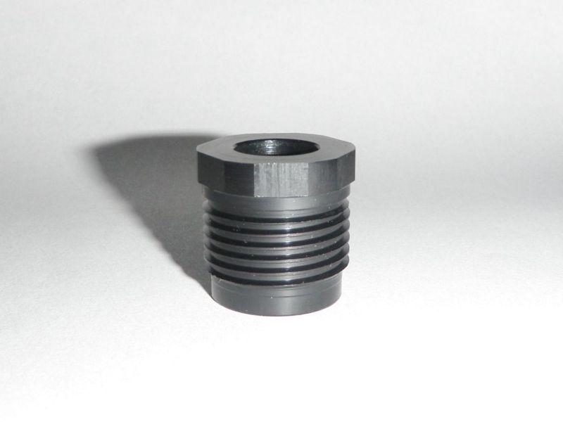

This past weekend I got the whole engine lid removed for easier working on stuff. Man that thing is heavy. I sanded and p all the rust off the hood struts and re painted except for the fronts which were rusted thru. I attached pics of each and the part number for anyone that may need it in the future. I also located the main leak. As you can see in the pics the plastic nut holding the cable thru the hull for the intake grate cleanout broke. Water was gushing in all around. I used a sprinkler pipe e-z out to remove the broken threaded part that was still stuck. That whole system is a joke, if I could remove it I would.
I still need to find my leak. I havent had time to mess with it. Are you going to replace those parts with the stock parts? Is it just that plastic threaded section?
That and the rubber washer. I didn't know they had them in metal, and ordered the plastic already. Guess I will e bay those and get the metal ones. POS plastic crap!!
