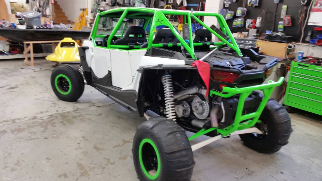

Lol. Just boring customer stuff. Only thing exciting to me about RZR is turbo install. Water cooled intercooler pretty cool.
Nothin on engine yet. Just watching craiglist for smokin deal on donor boat. My doesnt seem to notice hundreds of dollars out a week on twin projects. If I go write a check $4k for a donor boat I maybe sleeping on the couch! (: happy wife happy life!

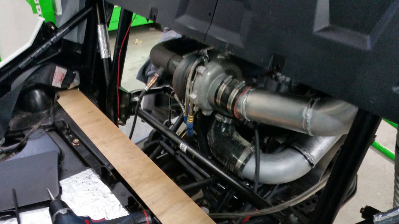

RZR is one of 7 we built for customer. Progressively getting more ridiculous . Pretty much daily type of exotic stuff we build sound systems in. $5k sound and lighting... blah blah boring car stereo stuff! But turbo is cool as hell custom manifold. Im engineering some heat deflection to keep turbo from catching seats on fire again. Customer complained his kids said my heated seats were stuck on full time.
Thing has a well engineered water cooled intercooler with electric pump and radiator at front. Wrecking havoc on my sound system. Fun stuff.

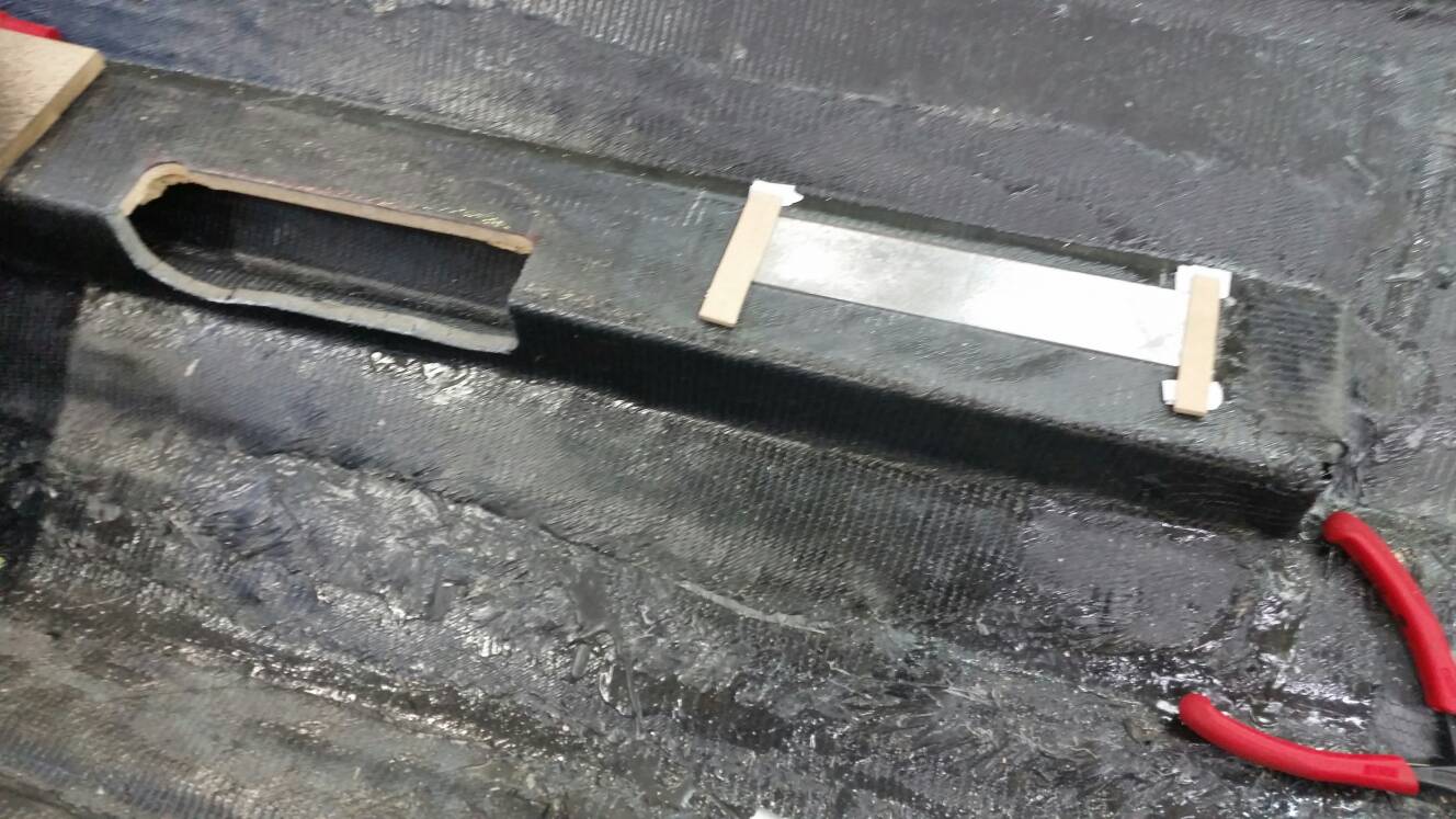

back on track Seadoodoc.. this is SD forum ..lol. seems I miss calculated engine height. So I had to cut out and countersink aluminum plates and reglassed ( cf). 3 beers ...21 mins. And itching like a mofo. Carbon particles are not skin-respiratory friendly.

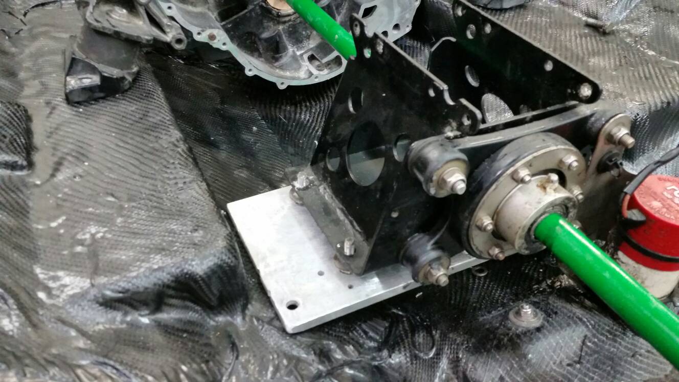

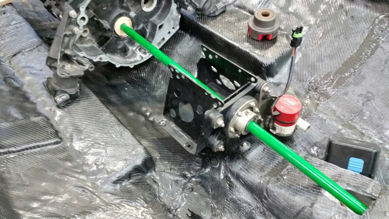

just chiseling away one hr a day. Some more broom stick alignment. Decided on two piece drive line to give more flexibity on alignment. Looks like cutting twin rxt shafts and threading on Yamaha couplers is going trend.
SeadoodocJR using plasma cutter for bearing carrier support plate. Did some exhaustive measurements on tolerances to ensure center and alignment. We made sure to leave room for shims. Adding height will be easy, however taking away will prove disastrous. Tough gig not having crankshaft. However " homemade " this project seems we are ensuring some serious accuracy in assembly.

We have a stock RZR and I don't understand these guys that spend all the money modifying the RZR's because for the same if not less money they could just buy a bitchn' sand rail that will smoke them.
The bike or Tesla, LOL.
BTW, great build.

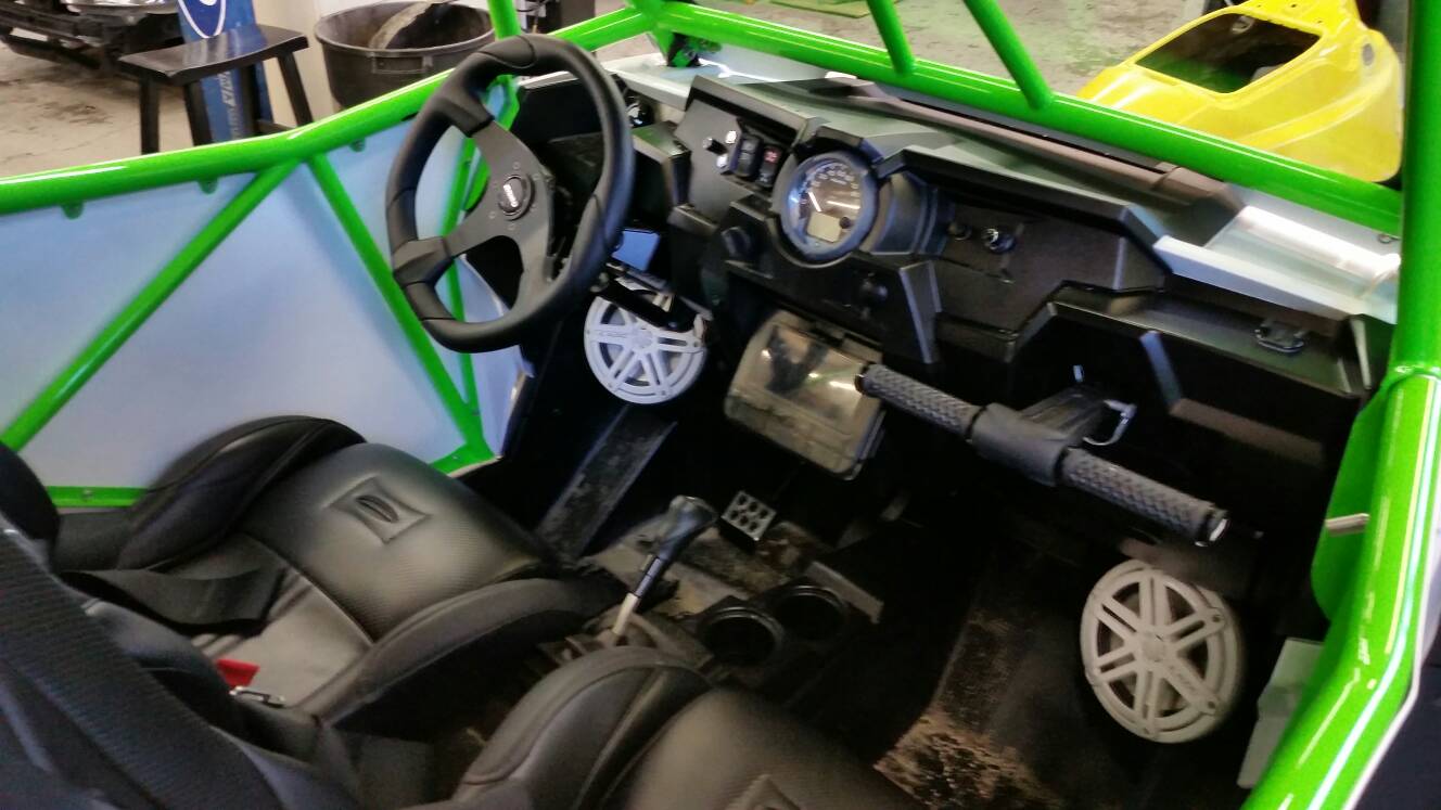

Okay the first pic. Is there no belt cover for that primary and secondary on those sand racers, or were you just working on it?
Good point mik, except sand rails cant go in the mud :)
Off topic.. but fun. We have found the 4 seaters will not survive a day at the dunes on a belt. We have tried fan cooling.. vented covers ..u name it. 1800 lbs loaded with an extra weight of 4 people. Then stereo and extras. So this turbo RZR we adapted a snowmobile wider belt and clutch system. Open air keeps cool and no issues. Obviously non functional anywhere but sand. It works finally. We have had many 100k 1000hp sand rails in our crew and has proven to be just unsafe for fellow riders on Oregon Dunes. Too damn fast and should stick to glamis. Any given day we see 100 built RZR's on Oregon coast. You cant run a full size buggy through trees and trails!

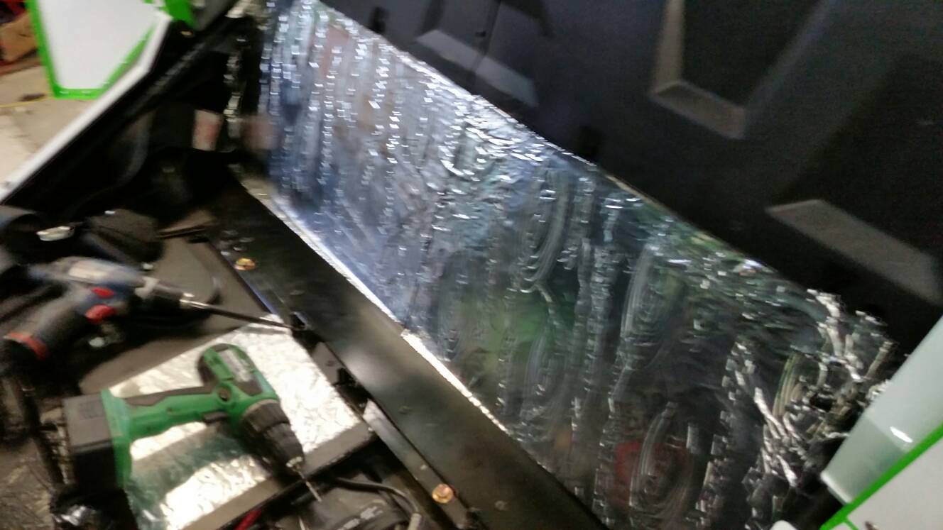

Workin on this frickin RZR is cuttin into my project time dang it. Pays the bills anyway. Full aluminum bent heat shield with Dynamatt to keep cockpit cool. Customer wont be happy with
my bill! (:
