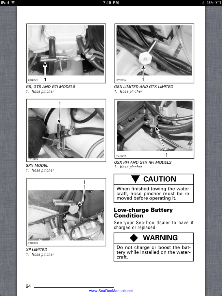

Ok so this is what I got from the manual...
So I'm gonna say that's the red arrow hose ?
towing:
the dealer installed a valve on this hose for us, brand new, we told them we may tow it w/our boat from time to time, so now if it needs towed we can open seat, flip valve, tow, etc.
it's been like that since new in '99... with nothing bad so far! 350 hrs on it! (engine rebuild at 300 hours due to exhaust gasket failure, followd by water injestion)
I put an inline on off tap on mine.Some comments were that people may forget to turn the tap back.A good call.I put a tag on the lanyard.Check tap and bungs.There is pics posted as well.I will try and find the posts
Found it.The thread is called,, PWC Safety Equipment . 02/17/11 and was started by Scottozy.Scroll down and my pics of the tap are there.Hope this helps
