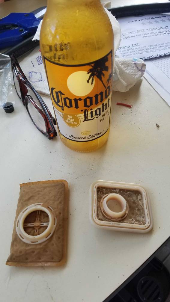

Thank you sir. Good point about the filter clamps. I plan on purchasing those clamps and tool just because of how bad the filters looked. I'm surprised this ski ran at all!!Yes, it appears to still be the best. They now include both strainers, the can filter, and tank gasket for a bit more than half the original price (now $80). They also still have the lifetime warranty! The gasket should not really need replacing, and if you can blow easily through the can filter I wouldn't replace that either since it usually involves double oetiker clamps on each side.
Thanks for your reply DooWacka and advice, I really appreciate you taking the time!
As a follow up to yesterday, since I had everything apart, I ended up using part of a fuel hose and sliding it into the silver shaft. It is a very tight fit but seems to work. I installed everything and the Seadoo started. I did some pressure tests and things seem to be working!!!! :thumbsup: I attached a pic in case it might help others.I am planning to use the Seadoo in 2 weeks so I will let everyone know if it didn't work!

	I have an inline gauge to install. Not easy finding one over 100. Should install it soon if I don't let the Marine specialist in the area at it this coming weekI never saw any statement about what your original problem was.
If you thought it was the fuel pump then you really need to measure the fuel pressure.
Placing he key on the post should give 27 psi, then hitting the starter button it should climb quickly to at least 90 psi to start, then run at 107 psi.
