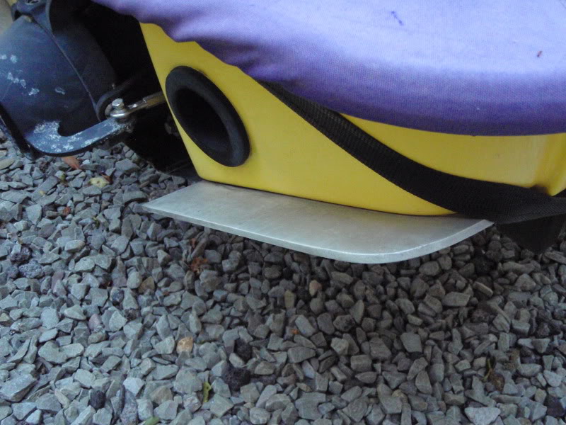

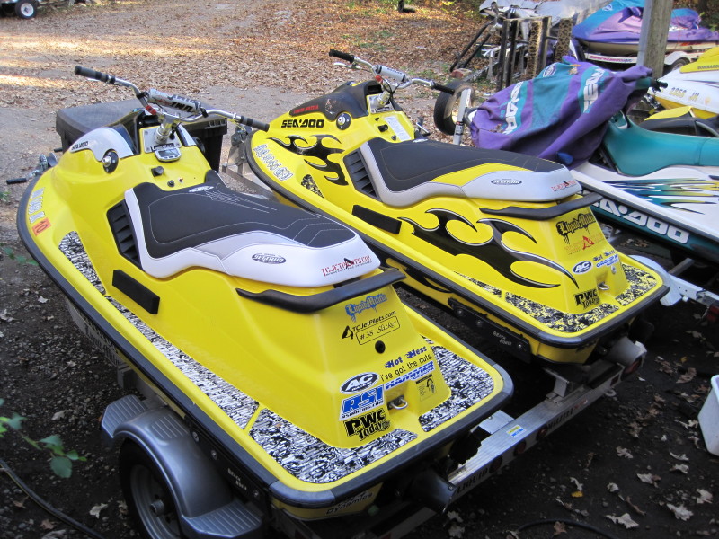

	DR...are those tabs plastic? I think they are beachhouse if they are.
Oh and on the manual trim...check out the left side of the bars in this pic:
my tabs look like the ones on your left ski. are those the stockers? i thought they where black?
anyway there is a set of r&d's on ebay right now for 35 bucks if anyone wants them.
Nope... they are flat aluminum plate.

This morning I took off the trim tabs, and put an 1/8" shim in them. Didn't do the math on the angle... but I'll try to give it a ride tomorrow.
Oh... and FYI... the tabs on my hull have to be home made. Once they were off... I can see that they were just 3/16 plate, and they were ground to shape. (There was rough tool marks on the front bevel, and bolt holes)
If anything, cut the tabs like the old Westcoast tabs. Unless you're very heavy and/or ride 2 up that much tab back there gives waaaay too much lift. Al little bit goes a long way back there. Any angle will drop the nose and KILL speed. You also want the tabe a little sharp on the trailing edge. Hydrodynamics.. it makes a difference.
Do you have a picture of the westcoast tabs? I lived up the street from them when they were closing up shop. I set up a JS440 with a pipe, rear exhaust, Waterbox, head w/domes, and flame arrestor... and I think I paid $100 for all of it.
I weigh about 240 right now... and I couldn't get it above 45 mph the other day because it was bouncing. (yes I was standing, with my weight forward) So... if I scrub 3 or 4 mph off the top... but I can run at top speed in control... then it is worth it. But I agree... I think I'm going to trim them down like the Works, and R&D tabs.
