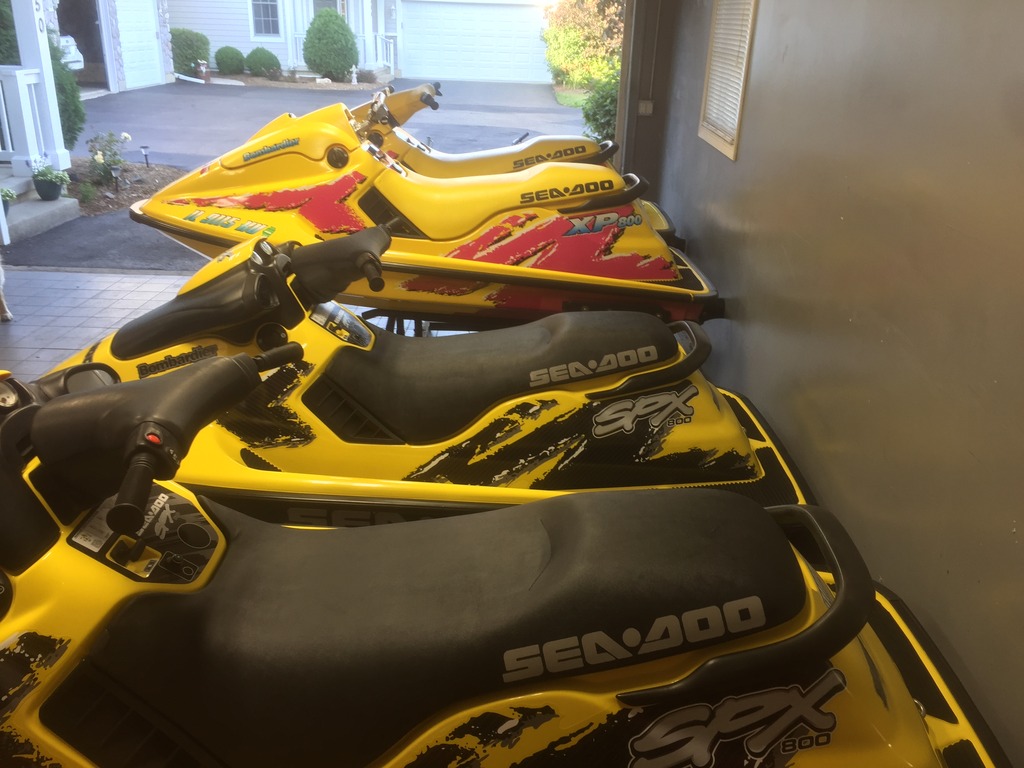

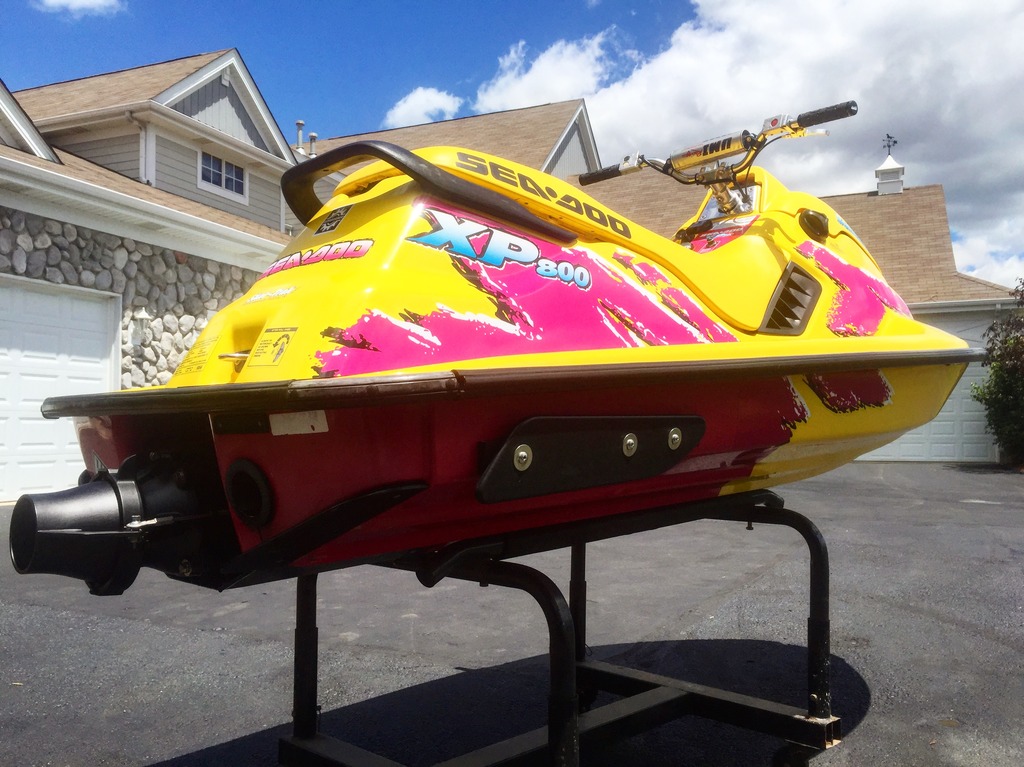

Here is a couple of my recent restorations

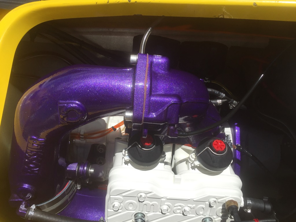

This one is my personal xp800
