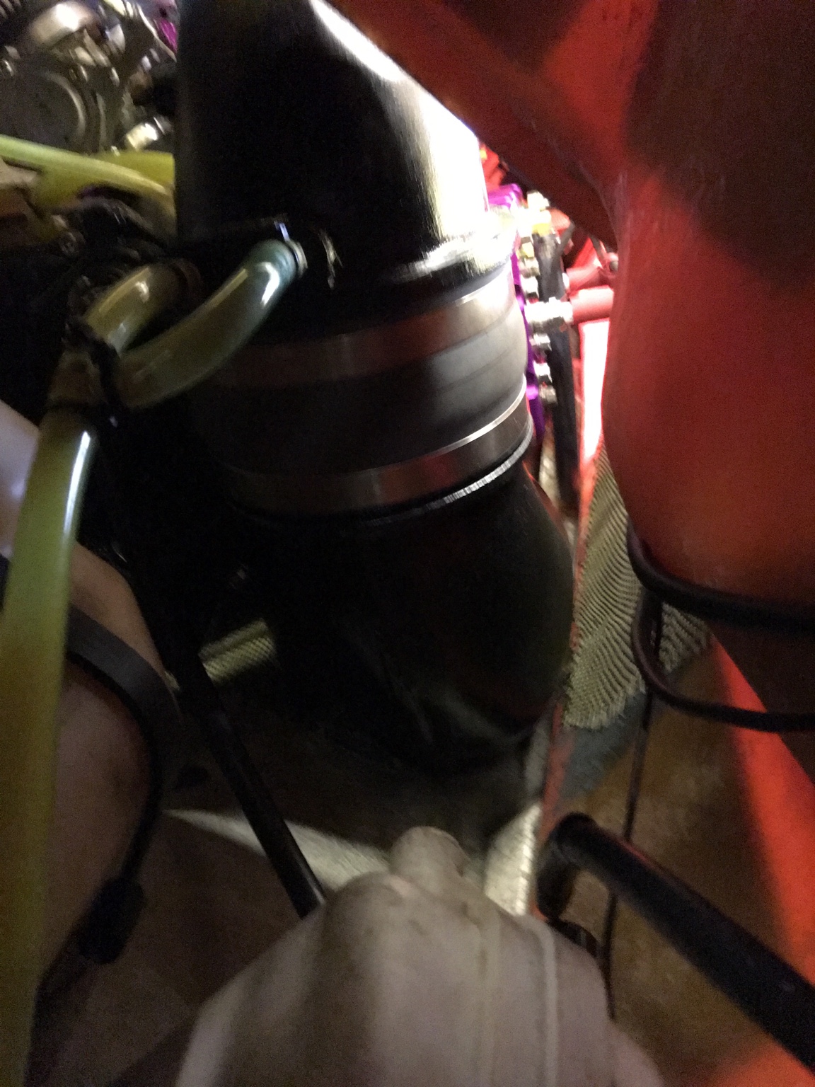

popped the decals off of the deflector this morning. The previous owner had it sprayed black with some cheap paint which the adhesive remover softened and smudged. Not sure if I want to have it professionally repainted or wrapped in gloss vinyl. I'm also curious if there's something else you guys would recommend as far as finished it off for rec riding. I added a bilge with a billet on/off handlebar switch and a little LED light in the panel turns on when the pump is running.

I do see a few things that worry me though....
The alignment looks to be a mile(kilometer) and a half off. This will wear your drive shaft splines out, especially with big power.
I'd use a little larger zip ties as clamps on the fuel hose connections or at least double them up and pull them as tight as possible with pliers before snipping the ends off.
Since your not using your temp sensor you could put a 1/4" fitting there to feed the stinger. Then you could have the fitting on the top of the exhaust manifold feeding the tell tale(pisser) again.
I would run it with the seat off or slid back and put a left hand on that ADA head during some WOT runs. If it's too hot to keep your hand on then you can exchange those brass plugs on top for 3/8" fittings and have them feed bypass fittings. I'm assuming that is water coming out on the top of the head and not going in, right?
Oh and on those Jetinetics RAVE caps the inside is not removed like on the original red caps. This means your adjustment spring is always on the tight side so the raves open later

The engine is lined up correct it's the angle of the picture.
I'll check the the zip are tight tho, I had a company called Jetshed build it they race in the British and European champions and used to race the 96 in the world finals back in the day.

I would toss those jetinetics adjusters. On a 787 they will actually not allow the valves to open completely at their lowest setting and cost you RPM.
back-to-back on my 97 SPX they cost me 100-150 rpm vs the red caps. Not sure why they didn't bother boring them out as it would take just a few seconds in a lathe.
Not too much then, I'll leave them for the minute. I ride surf so I won't really miss them Rpms to be honest. Thanks tho
