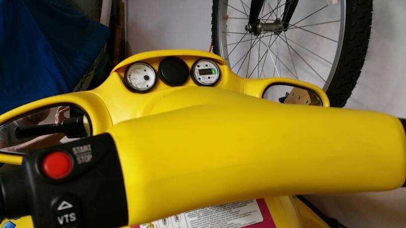

Thanks anke for the gauge block off! Looks much better than the hole that was there. I was going to paint a seadoo logo on there, but that's more work than it's worth with my limited free time.
