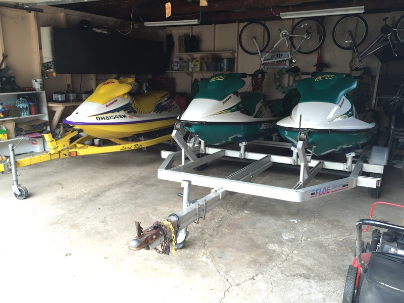

I just bought 3 X4's. 1 95' XP and 2 96 SPX's. The XP is clean besides some handlebar mold and the SPX's look like they came out of the showroom besides some gelcoat knicks and one decal is a little torn.
I am going to do fuel selectors, fuel filters, fuel lines & carb rebuilds in all 3. I took the XP out yesterday and it ran great but I've been down this road before and I know what needs to be done first!
