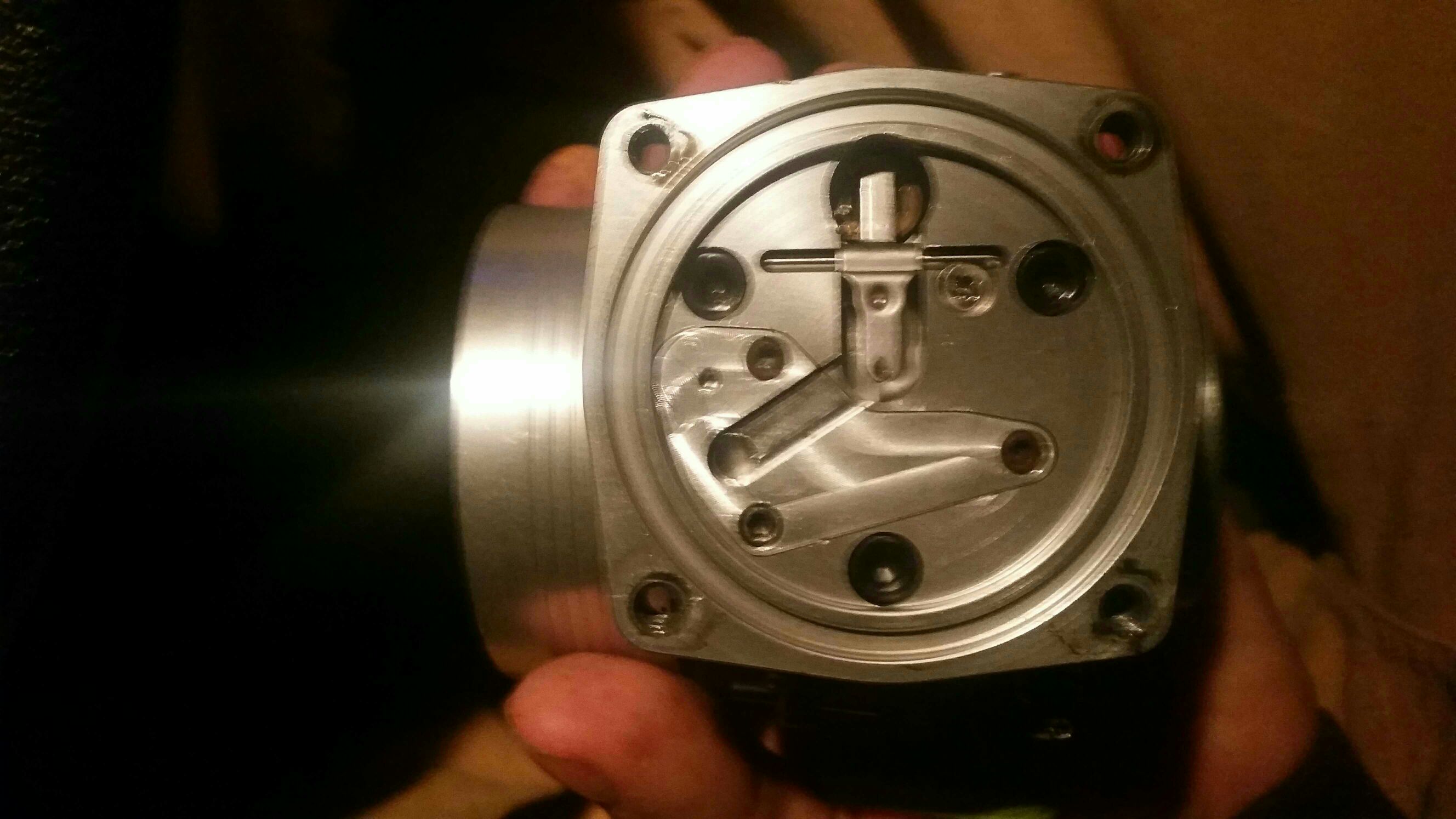

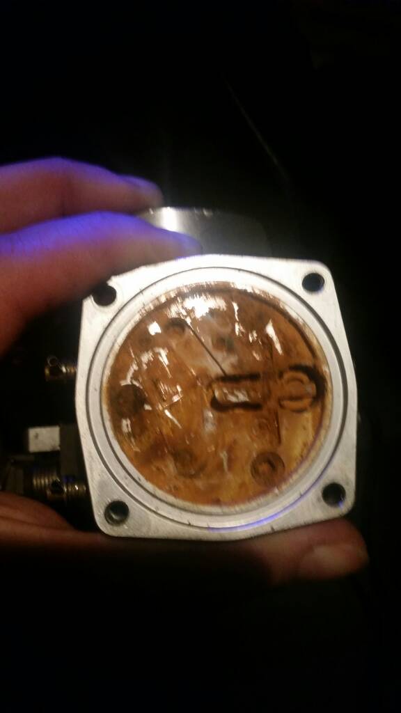

I'm so pissed I message the guy and sent him a pic of the inside of the carb.
Id be asking for some freaking money back. That's just ridiculous and I'm sure those were not cheap

That depends on the circumstances they were sold under. If they were advertised as "from a running ski" or "ready to go" then I can see calling him out. If they were just thrown up on a forum like.."hey found these" or "here they are you deal with it" then I would not be upset.

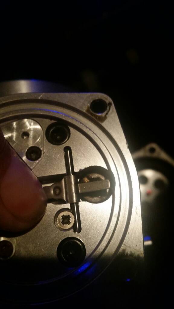

I buy tons of stuff on the used market and this sort of thing is pretty common. All these donor skis died for a reason. In this case it looks like the death involved the ski sinking. The rust will clean up from the billet aluminum fine but I'd be worried about the hardware breaking while you try to get them apart.
My concern is the screws being seized by rustI bet all that surface rust comes right off with a wire wheel or some naval jelly. Its more work than I am sure you anticipated but its just time in the end.
280.Dayum. What'd you pay for them?
40 of it was shipping280 is a bit high for carbs in that condition. look at it this way, if you drill all the hardware out and install new ss hardware then you at least know where you are with the carbs. the only thing that stinks is the $$ that will be involved in updating them to the push-in needle & seats, and possibly even the bomb site modification from Miller.
