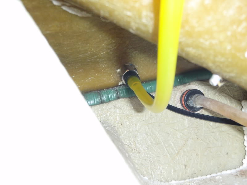

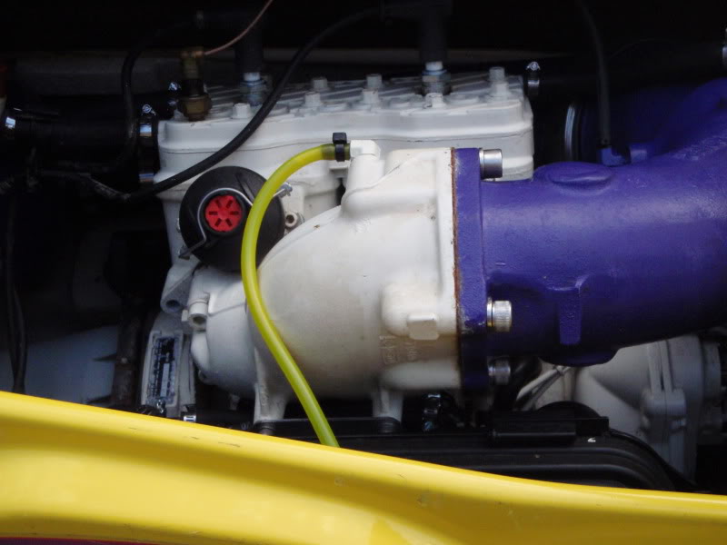

I installed the Tell Tale on my 96GTI today, works great. I installed it on the port side because the 2004 is located in the same general area. I had to remove the styrofoam and cut about a 1" notch to allow for clearance of the hose connection and fitting.
Worked out real well I used 1/4" fuel hose because that's what I had in the garage. I re-plumbed the hose slightly, I moved the "T" connector close to the outlet on the exhaust manifold and ran a new hose to the exhaust and the new hose to the pee hole. It took about 8' or 9' if you locate it on the starboard side figure a couple of more feet.
