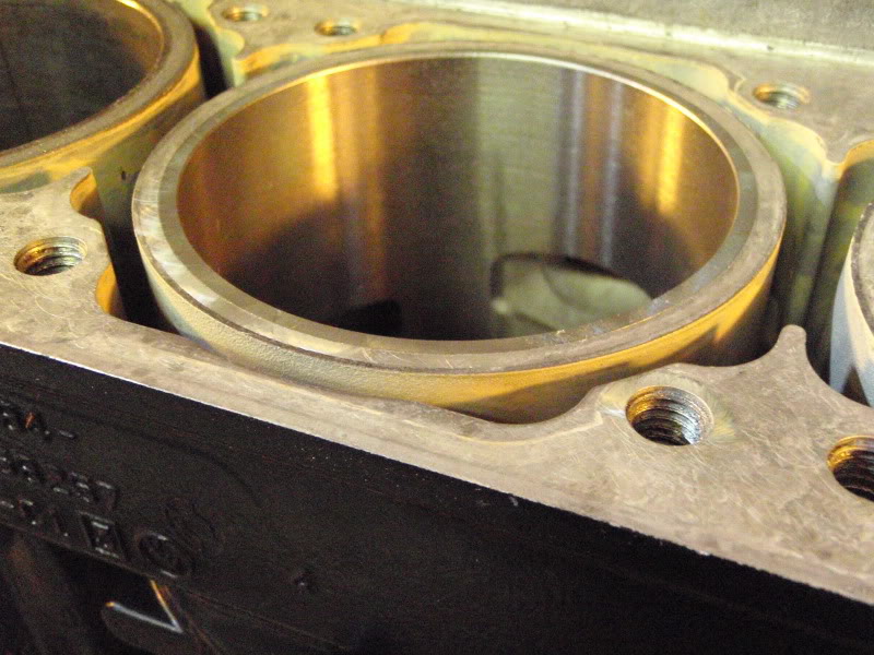

When you sleeve a cyl.... you still have to bore it. The OD will be ground to size, but the ID will be undersized by around 0.015" They do this because, if you get a warp or bulge... you can machine it out later. The only liners that come pre-sized, are press-in sleeves. (large diesel, and some gas)
Also... tell you buddy he's wrong. (on the sizing thing) A few thou on a cyl, isn't going to make a measurable power diff. AND... it's common practice to run different sized bores in the same engine. It may not be the best thing in the world... but it will get you running for less $$$$.
When you set a seadoo sleeve... you cut out the old one (carefully) and leave the cyl, about 0.004" smaller than the OD of the sleeve. Then, heat the cyl (bake it at 450 deg F for at least 45 min).... drop the sleeve into place.... wait about 10 seconds... and the cyl will cool, and grab the sleeve. Then, cut the deck, boar, hone, match the ports, and chamfer.
Simple. (lol)
Simple. (lol)

So basically the sleave is pressed and then boared out that makes sense.
