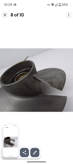

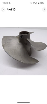

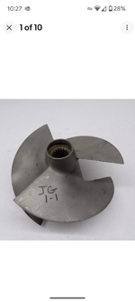

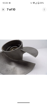

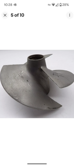

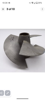

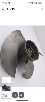

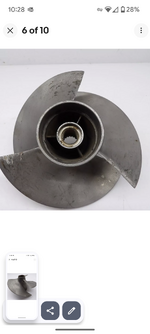

How can you tell if an impeller is an okay shape I found this OEM one on eBay.... Guy said it needs a little sanding on the edges but is straight. $80 bucks.

That impeller is bent on the trailing edges.
As far as telling if the pitch is bent or diameter is worn you really can't. You need to send it to professionals like Impros.
