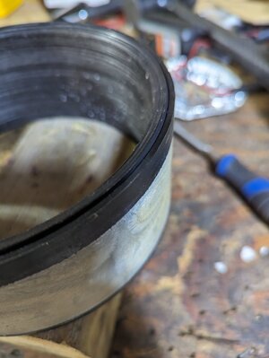

Hey all seadoos running pretty good I've got a 1996 GTX 787. Done a lot of reading on the forum here it sounds like a wear ring issue but I just put in a new WSM ring... Clearance looks pretty similar to the one I just took out maybe get 0.4 to 0.5 of a millimeter between impeller and wear ring with my feeler gauge. Basically when I punch it from a stop it does start moving decently, but is hitting 7000 RPM and just feels like the tires are spinning and then it really grabs after a bit. It always comes up to plane no problem. Just feels like it's missing a little bit of traction at the start. It came with a stainless steel solas prop I believe. Every other speed no problem, just when you punch it, maxes RPM and spins the tires for a little bit but is still having forward momentum during this time just doesn't grab hard for a few seconds into it.

Did you replace the neoprene seal?
Haha funny you mention that. Was debating putting one on but there isn't one listed for this model on the parts diagram, and the wear ring has a flexible rubber seal built on it which I'm guessing is why they don't show one required.
There is a neoprene seal in my 1994 GTX parts diagram, but I guess they changed something on this model? I can definitely put one on, but I'm thinking they did some design change for the 96 and they don't require the neoprene seal. But again I have no issues trying one...

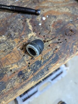

No I don't know if these ones require it? I'll definitely throw one in though if it doesn't hurt anything! Plus I just realized I forgot to put my little rubber seal on the end of the drive shaft that goes into the pump. I imagine that just stops it from corrosion more than anything else...
It can help with some cavitation.
But yes, you should be running a neoprene seal.
