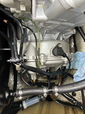

so I got a new to me oil pump. I bled the supply hose and the filter as much as I could. Maybe just a very small air bubble in the filter. I’ve been squirting oil in the cylinders before cranking on the hose. Once cranked and water flowing, I’ve been turning the pump full open. It is pumping quick but is pulling air from somewhere. I’ve tightened the hoses as much as I can so am not sure where this air is coming from. I finally got oil in most of the small line on the left. The one on the right is pushing some oil but only a little. Ive done this cycle 7 times now and the right line isn’t getting any better. Any ideas guys? Shouldn’t both lines be full of oil? It did start smoking once the left line got completely full of oil.

I’m not sure why that line would not fill with oil but better hold off on cranking it till it can be figured out. Which lines are you speaking of when you say you have tightened the lines as much as you can? If it’s the small oil lines, they fit so tight on the nipples tha to they are a real bugger to get on. The only other thing I’ve read was the check valves but I don’t know anything about them. Sorry, hopefully someone comes on that can help.

Yea, the small oil lines are the ones I was talking about.

Ground your spark plug boots and while cranking hold the oil pump wide open. Should see the oil fill the lines

So don't actually crank it? I just ground the boots and turn it over with the pump held open? Any idea why the one line wouldn't be filling up like the other one? Also, fluid seems to go through it a lot faster than the line that is now full of oil.
No, you have to have the engine turning over for the oil pump to work and if it isn't with the engine actually running at 3,000 rpm it isn't going to just cranking at a few hundred.
Yes, both oil lines have to be full and pumping, one is for each cylinder.
If one isn't pumping, make sure the nipple on the intake manifold isn't plugged on the one that isn't pumping.
It is pumping but it's like it isn't picking up much oil or is getting air in that line. I can see oil being pushed through the line very quickly but only a very small amount at a time. It's mostly pushing air through that line.
I agree it is strange but it has to be an air lock somewhere and probably in the pump body as the pump is working, just not that one side.

I was trying to find a solution for this last night and couldn’t get a definitive answer by looking through old threads. Where are the check valves on these 787 RFI’s? are they in the oil pump? I’m guessing they allow oil to go through the pump into to the small oil lines and then close so as not to allow it to back flow? Could it be possible that the one check valve is clogged or broken and not opening? I think I read it takes 3 pounds to open the check valve, not sure about that though.

SMH. So I bled the pump again…twice. Replaced the hose that wasn’t getting oil through it. Had to run it 4 times but it finally got oil all the way through it to the cylinder. It no more than filled up when the other line stopped pumping oil. So now the one that was full is empty and the one that was empty is full. What gives?
Could this be the check valve?

I’m now wondering if you’re onto something here. I wonder if the check valve isn’t opening as much as it should. When one tubes pressure gets higher than the other tube, it starves the other tube so it can’t get enough oil. The check valve is only opening enough to supply one side. There appears to only be one check valve and it is above the oil tank.
I was asking, I don’t have a good grasp on the check valve thing at all. From my reading I thought there was one in the oil pump but couldn’t find any good information to confirm that.
They are on the intake manifold/rotary cover fittings.
The one above the tank is just a vent.
Since your not getting any replies right now, just to recap. You got a new to me oil pump, did you bench test it with a drill at 1500 rpm in reverse? I can’t remember how much it’s supposed to output at, but it can easily be looked up in the manual. If it passed then I would think the only place to look would be the nipples where the small oil lines attach. If it didn’t pass then get another new pump. Highly irregular for these pumps to go bad. When your trying to fill the lines ( only try to fill the lines if the pump passes the bench test ) are you actually starting the machine? Add some oil in the plug holes, start the machine, then reach down and hold the oil pump wide open. If the pump passes the bench test it should fill those lines up in seconds idling with the oil pump lever held wide open. Don’t run the machine more than 20 seconds. No need for the water hose.

I tried the bench test but wasn’t sure I was doing it right as I never got oil to pump on the old one or the new to me one. I am starting the machine. I have been putting oil in each spark plug hole prior to starting. I have been putting it on the water hose too. I have been running longer than 20 seconds but been keeping it around a minute or less.
