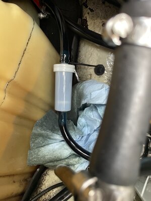

You have to get the air out of the filter first.
1. Hold the oil filter vertical and pull the hose off for a split second and it will purge the air. Lay down some paper towels as it will make a mess.
2. Open the bleed screw until clean fresh oil comes out and no air, this only fills the pump.
3. Start the engine and hold the oil pump lever wide open. This will go to max flow and pump oil into the two small oil lines very quickly.
4. Let everything cool then do step #3 again until oil is all the way to the intake manifold and the exhaust starts smoking a lot.
Compression is low but you are out of warranty so you really have nothing to lose at this point.
I got the oil completely out of the filter. I opened the bleed screw until I didn’t see any air. Started it up, pushed the lever to wide open. The pulsing was quicker but still only bubbles. I can’t tell it is getting any better. I’ve done 2 cycles of a couple minutes each so far. If I open the bleed screw all the way, should oil pour out of it? It doesn’t.
Post a picture of your oil filter again, you better slow down with running it for 2 minutes at a time because It looks like your running it without oil

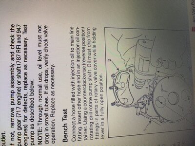

0C0ECA4B-70A6-411E-B6F0-12340E8D65C3.jpegI had a look at the 2002 shop manual and they do show a procedure for bench testing the oil pump, also did a little searching on other threads and it looks like your looking at a bad pump or check valves. You can get getthe shop manual for free at seadoomanuals.net . It doesn’t look to complicated to bench test the oil pump.

I would first take the hose off at the oil pump and make sure you have good flow out of the tank, filter and hose.
It sure sounds like you have a blockage.

I took the pump off. Attached a supply hose and two pieces of small tubing to the two outlets. I attached my drill contraption to the back piece, filled the supply tube with fluid, turned on the drill to high in reverse and it would not pump the oil into the outlet tubes. Unless I’m missing something, I think the oil pump is toast.

The only time I have ever heard of one of these oil filters clogging is when two different oils were used and it created a thick gel from a chemical reaction.
If it was mine I would first check compression.
Then install a new oil filter and make sure it has good flow to the oil pump.
