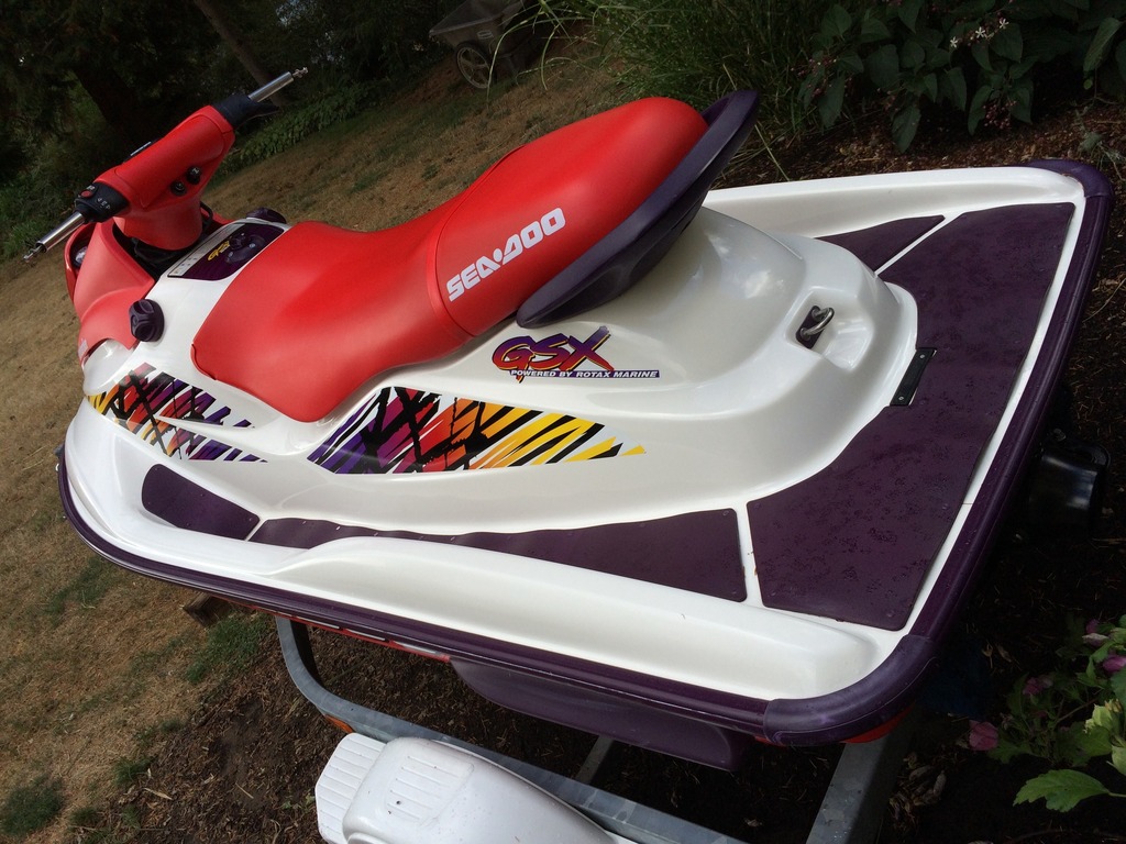

As the title says, I just picked up a 97 GSX from its original owner. I paid $1300. This is my first ski.
The ski has 68 hours on it. I have all the service records since new. Other than yearly winterizes/dewinterizes and batteries, the ski did have a top end rebuild performed at the dealer about 15 hours ago during the summer of 2013. The owner says they were "zipping across the lake" when the ski made a noise and died. The compression test showed 145/30. It was bored and honed and oversize piston kit installed by the dealer. The cause of the failure was not indicated, but it would probably be reasonable to conclude that it was lubrication related. With such a sudden failure, it almost sounds like a piston broke. I wish I knew what they think caused it, but the service record is silent on that point. They must have inspected the oil pump and injectors as part of the rebuild, but I can't see that this was actually done. What should I do to verify that I don't have a time bomb here? I would rather not convert it to premix unless I have to, but I value others' opinions on this.
One sponson was damaged by an impact with a dock in 2012. It was replaced with a black one, so I have one purple and one black. I think I will paint them both black. I am not going to try to paint over the remaining purple parts. I thought about it, but have decided to leave things as they are.
I did test ride it when I bought it. It runs strong, pulls hard, accelerated smoothly. Top speed on slightly uneven water was 57 indicated. I think it would go a little faster on glass. I believe that is about as fast as this ski is supposed to go.
Compression is about 150 on both. I cannot see any damage to the impeller or the wear ring, and with 68 hours I would not expect the wear ring to be an issue.
The ski is very clean inside and out. It was never used on salt water. There is no corrosion on anything anywhere.
The mats are puckered up. I am ordering black/red Hydroturf after I receive my samples.

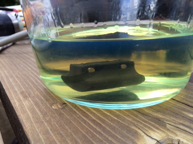

Absolutely! If they are really gunked up, a simple way to clean them is put the raves in a ziplock bag with a little ammonia and let it sit overnight. the fumes from the ammonia melt thru all the gunk and it wipes right off. if you don't want to wait overnight some use oven cleaner but it's more work.

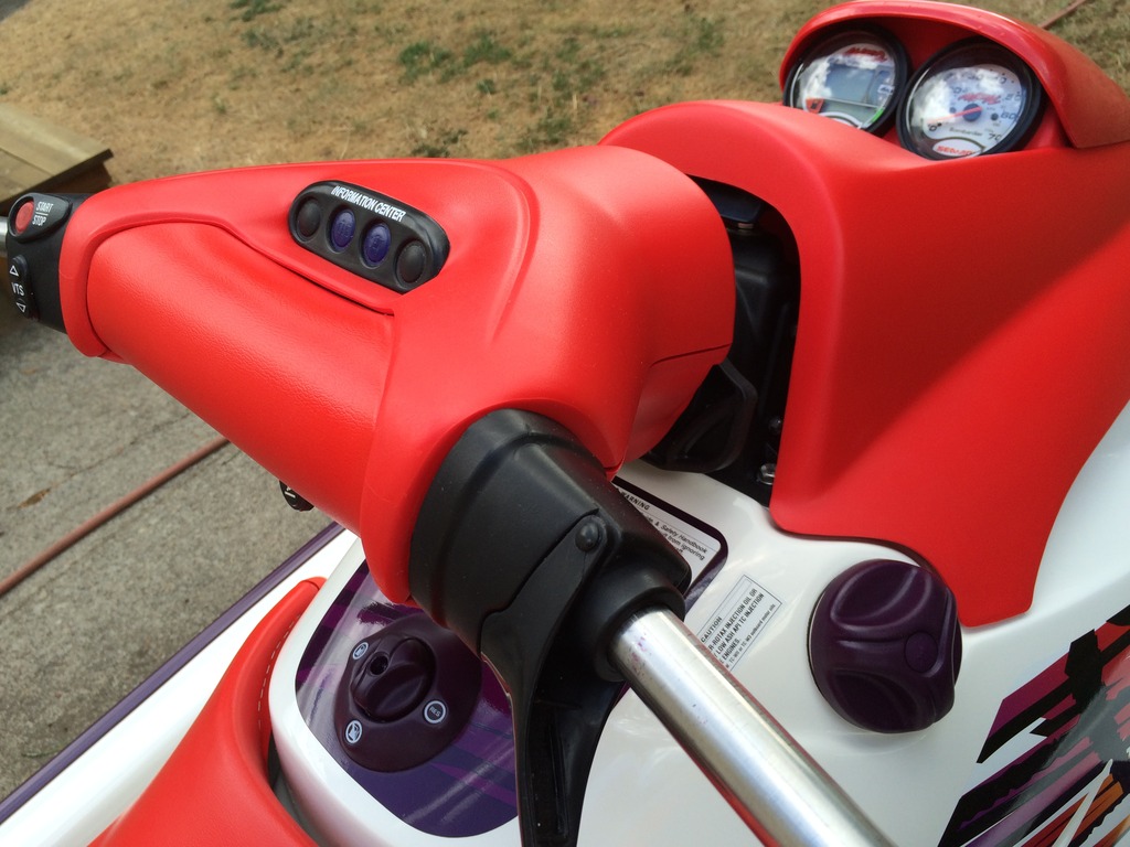

Ordered, received and installed new start-stop button cover from eBay. Ordered new oil filter, $9, not yet received. Ordered Hydromat samples, not yet received.

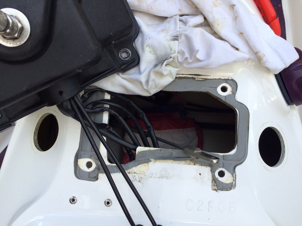

In order to get the baffle out, I had to remove the steering head and the cable where it attaches, the MPEM (but not the bracket), the oil and fuel sender wires, and the filler hoses for the fuel and the oil tank. Was able to slide the oil tank back while sliding the fuel tank forward.

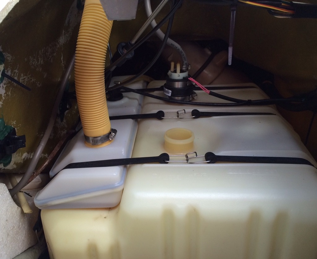

Sender did not have any internal faults on the circuit board, but the float didn't float anymore which is why the gauge read zero. Here it is sitting on the bottom of a pint of gas. Hmmm. How hard is it to make a float out of something that actually floats? But I digress...
New float, part #295500438, is $11 at the dealer. Popped it in and the resistance readings are as they should be.
All buttoned up, just need to cut and install the fuel lines.

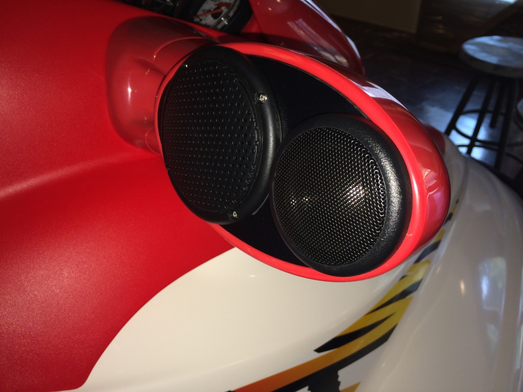

I decided to go ahead and add mirrors. Not for the mirror in them, but to use them as speaker pods. I don't want to cut holes in the deck to install speakers so I am going to go with speakers in the mirrors instead.
In addition to the mirror-mounted speakers, I'm also going to add an 8" subwoofer inside the nose ahead of the storage bin. I'm going to fiberglass it in, using the existing shape of the nose as in an enclosure, in order to keep the weight to a minimum. To power it I'm thinking of a Kicker bluetooth amp/controller PXIBT502, which I should be able to install without cutting or drilling any visible holes in the ski.
Because I don't need to be able to see out of the mirrors, I am open to using any factory mirror that's the correct Viper red. I don't really want to use the big mirror base. There are several on eBay but the prices are a little on the high side. I know there are plenty of forum users parting out skis...should I just place a WTB ad? I don't want to break any rules here.

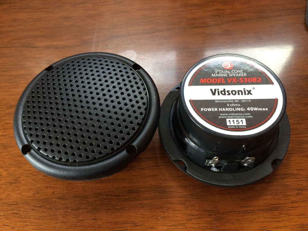

I found a set of used mirrors on ebay and made them into speaker pods. You have to break the mirror glass to get to the screw that allows you to remove the pivoting mirror holder. A little time with a dremel is necessary to clearance the interior of the mirrors.
I made the mirror face out of textured ABS. It is held in place by friction and red RTV silicone.
The speakers I used are (I believe) the same ones used by other suppliers of waterproof PWC speaker systems. They are sold by Vidsonix and are totally waterproof. There is a 2" tweeter with built in crossover and a 3" mid. They are four ohm speakers and are connected in parallel.
Vidsonix has its own website. Not all their products are shown. Best to call them in order to get exactly what you want. Price was very very reasonable and the service was excellent. The tweeter comes with multiple grill options--everything from satin black to full disco fever.

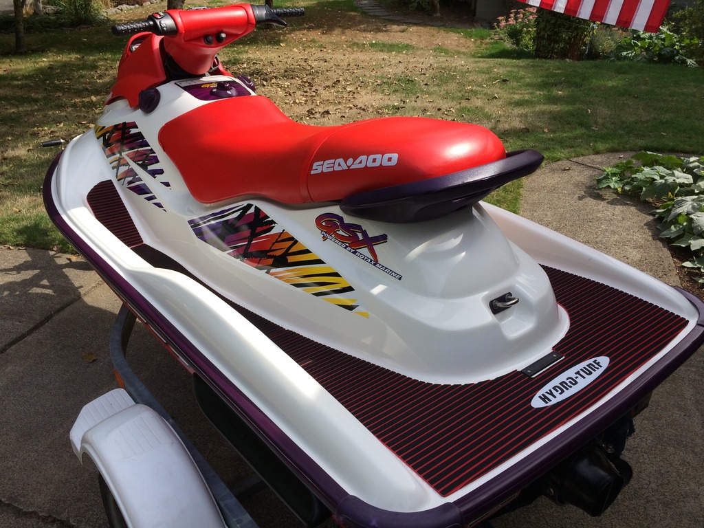

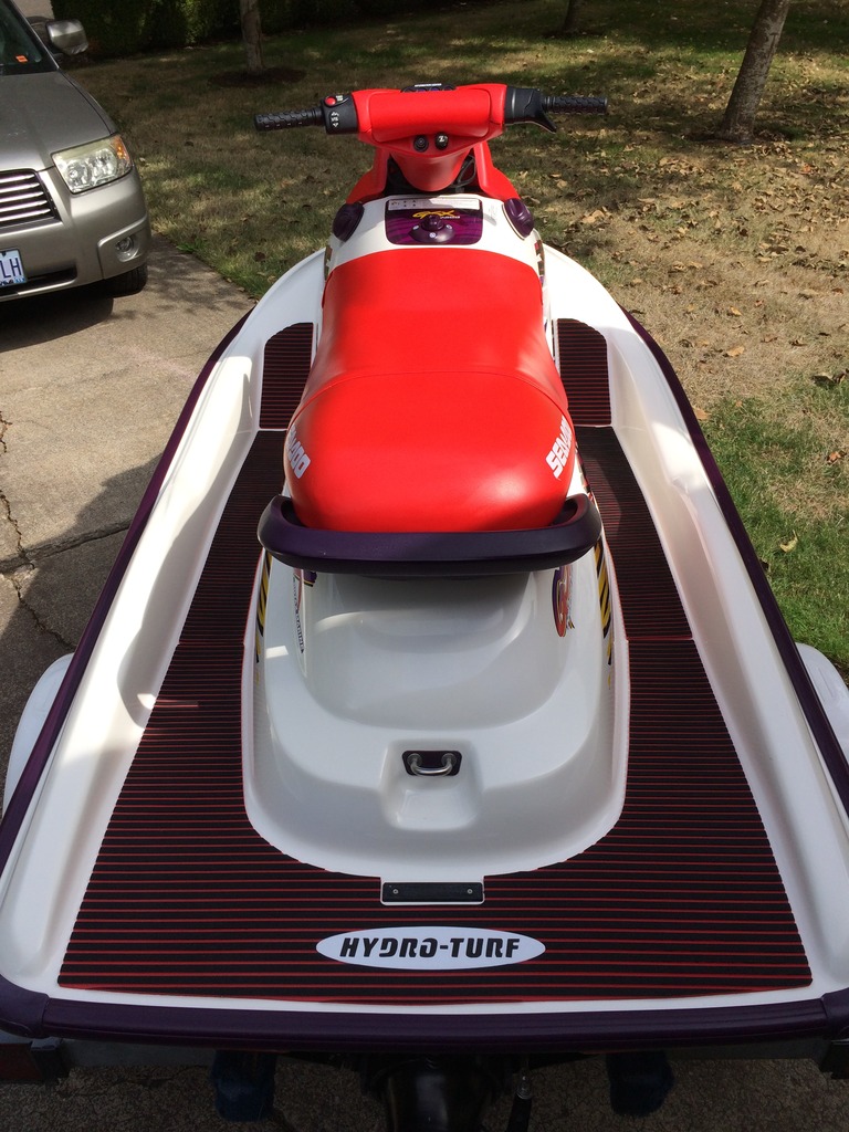

I thought I'd share photos of the new mats I ordered through PWC Muscle. As suggested by others, I just drilled off the heads of the old rivets, pressed the remnants down slightly below the surface of the deck, and covered the hole with a dot of epoxy. These are nice mats.
I also got a new Poppy cover. They are excellent and well worth the money.

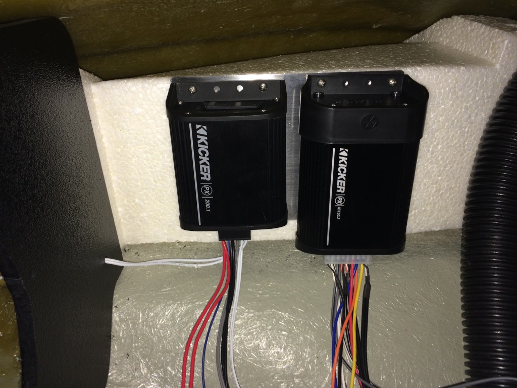

I went with a pair of Kicker amps. They are intended for vehicles with limited charging systems and are rated for exterior use. To mount them, I first cut a piece of stainless sheet and adhered it to the flotation styrofoam with contact cement, then drilled holes in the stainless to mount the amps.
The control amp is the Kicker PXiBT50.2. It has two channel output, 25W X 2 @ 2ohm. I have two 4 ohm speakers wired in parallel so I am getting the full output. It also has a low level output that feeds the second amp, PX200.1. That amp is a single-channel, subwoofer amp and has a low pass filter built in. It powers the 8" Polk Audio Marine subwoofer and is stable down to half an ohm. The subwoofer has two 4 ohm voice coils, so it presents a 2 ohm impedance to the amp and results in a 50 watt output from the amp.
These amps are fully digital so they don't overtax the ski's charging system.

It is direct to the battery.
The amp comes with a waterproof keypad where you can turn the system on and off, adjust the volume, mute it, and change tracks. That is one of the main reasons I bought it--I did not want to be fumbling with my phone every time I needed to turn down the volume. Eventually the phone would either get wet or end up on the bottom of the lake. This way I can pick a playlist, put the phone in the dry compartment, and leave it there where it is safe.
The amp also has a USB port so you can charge your device.
A subwoofer is not directional. It can be anywhere and you hear it just as well as if it were right in your face. It uses the hull of the ski as its audio chamber. That is why in a car, the subwoofer can be face down in the trunk--it doesn't matter where it is.
This thing is very loud. I am sure I will be able to hear most music quite clearly at WOT. Boat stereos are of course a lot louder but I don't want to be a total nuisance and these skis have a very limited charging system so there are constraints on what you can do.
