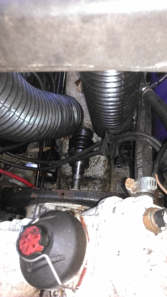

Looking at your pictures, I cant seem to see the rubber boot that attaches to the PTO from the drive shaft, to me it looks like it is missing. If it is there great, if not you should install one.

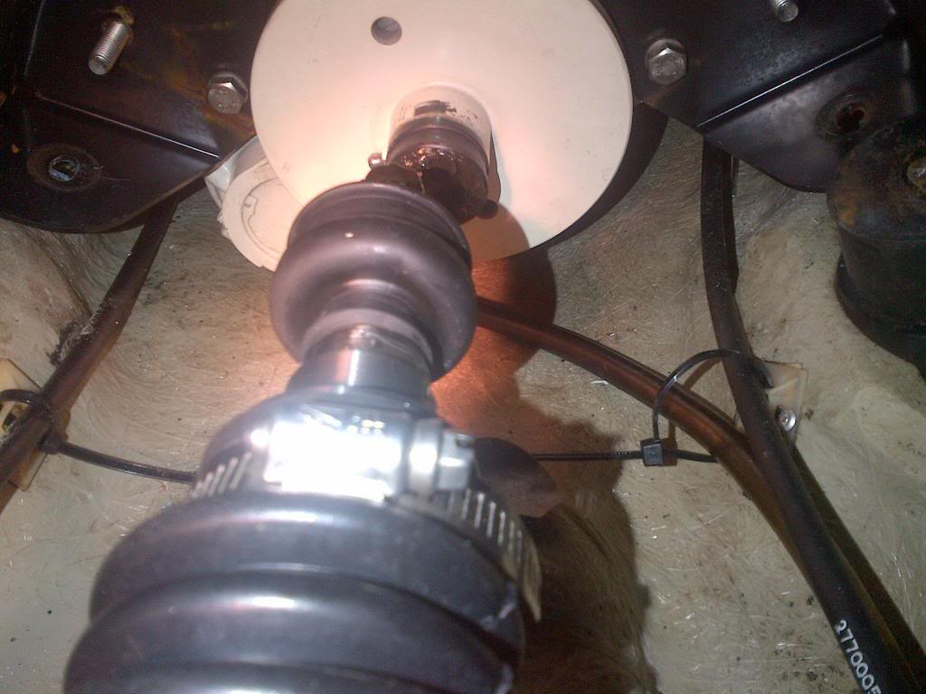

This is the boot that should be attached to the PTO

There is a battery vent line from the front to the battery area that is just for looks (not really, most everyone uses an AGM sealed battery so you won't need this vent). And again, as someone pointed out, the boot covering the pto to driveshaft greased splines is missing. You will want to order this, install and then grease.
replacing the PTO boot is going to require removal of the jet pump, so probably go ahead and start shopping pump rebuild stuff, "while you're in there"
