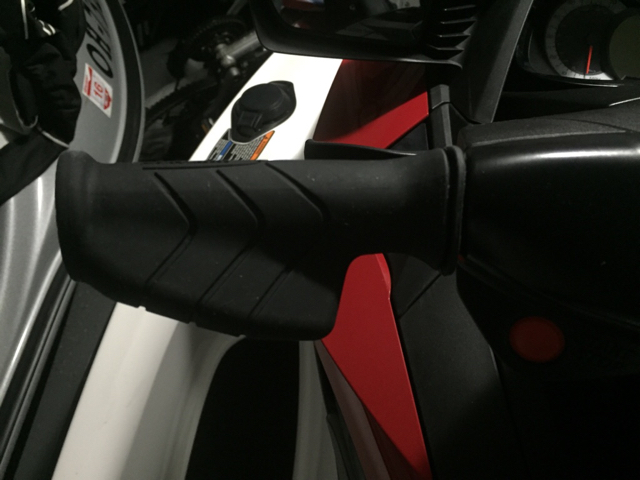

Here are the pics.
I used the new 2016 grips and the ORIGINAL retaining bolts and plugging caps. You need nothing but the grips themselves.

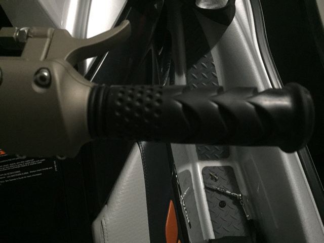

On the RXT-X, which have the regular round grips and are not tapered on the inner-ends, there is a TINY gap. Can only be seen from the seat like if you were sitting driving. I put one on each ski and then sat on the seat. I can tell for sure there will be MUCH less general fatigue for cruising and what not. I could see where a high speed racer may want to keep a smaller rounder grip as they would wrap their hand all the way around it. But for general use, this is a very cheap and worthwhile upgrade.

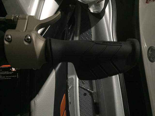

Here is the GTX. (Mine is a 2010).
This grip looks light in color and faded, but it is not. The light turned off in the garage and this is the result of the flash,, LOL

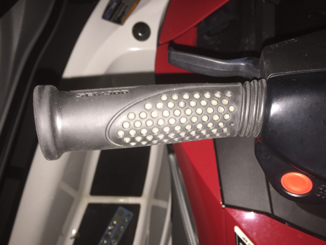

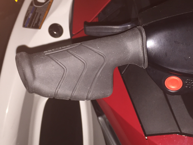

Here is the RXT-X. (Mine is a 2009).

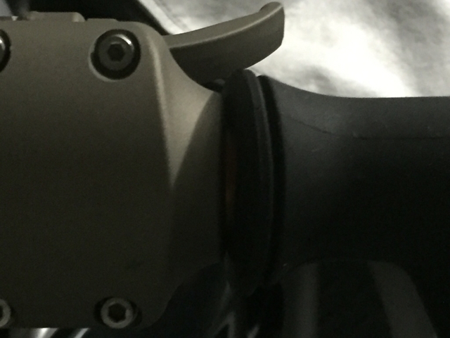

Here is the gap. So small it is not worth screwing with. Though the larger triangular inner-edge does not fit like the smaller round grips, they still look like they belong there. So I am not changing anything, just putting them on ad using them.

Just a thought if that gap bugs you... How about an O ring that fits over the handlebar and gets squished when you crank down on that 10mm bolt.
Cranking on the bolt will not help as the grip bottoms out on the outside edge. But an O-ring could help camouflage it a bit for the mere fact that there is room for it. You could also use black RTV. But it is so small, I'm doing nothing about it at this time. Maybe I'll change my mind in the sun light.

[MENTION=74710]DavesNotHereMan[/MENTION] f you do want to fill the gap on the non-tapered grip skis, you could shave about 1/8th of an inch off the end of the grip bar. This would allow the grip to move in toward the center of the ski...

Good idea on the shave. If it's only 1/8 inch, a little run on a sanding belt should get that pretty square.

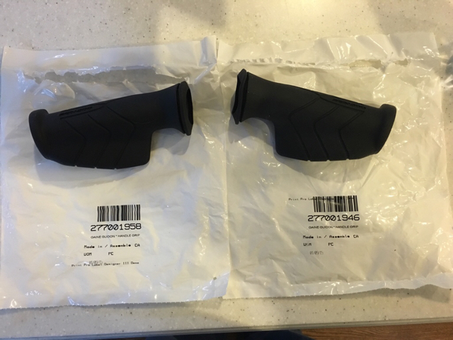

Left Grip: 277001958
Right Grip: 277001946

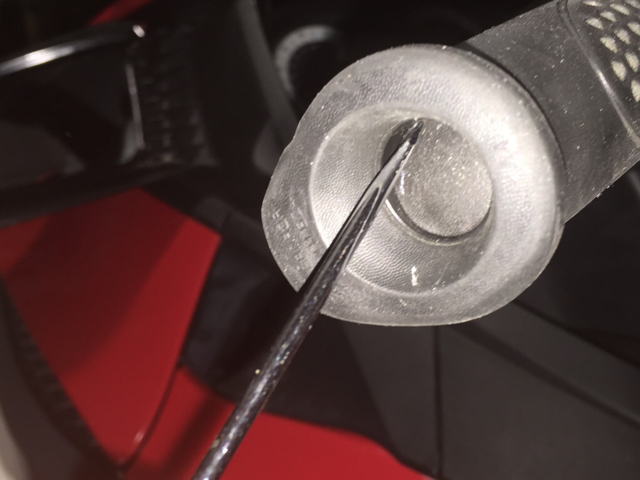

Using a small flat-head screwdriver pry out the end-cap of the grip.

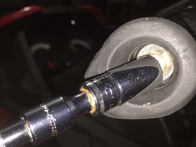

Using a 10mm socket, remove the retaining bolt.

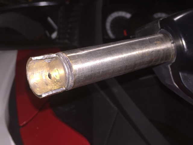

Grab the grip and pull it straight off the handle bar. You will now see there is a notch in the bar. This notch is what keeps the grip(s) from rotating once installed.
