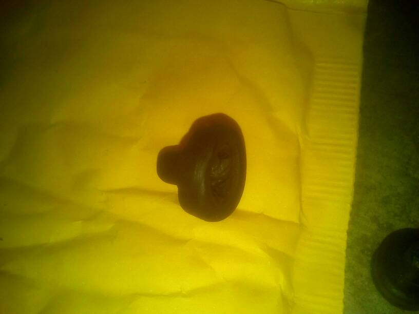

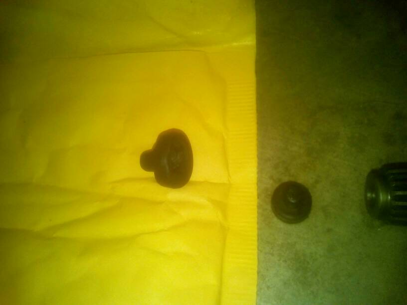

In addition to the Rubber bumpers at each end of driveshaft, is there supposed to be one in the PTO? When cleaning out old grease inside PTO I felt a rubber piece and pulled it out. its a different shape and size than the ones that fit on drive shaft ends. Here's a pic with the one from inside the PTO ositting on the envelope :
It just looks like an old deformed one. No, not one in the PTO, just one at each end of the driveshaft is all that should be there.

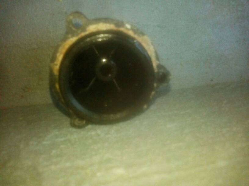

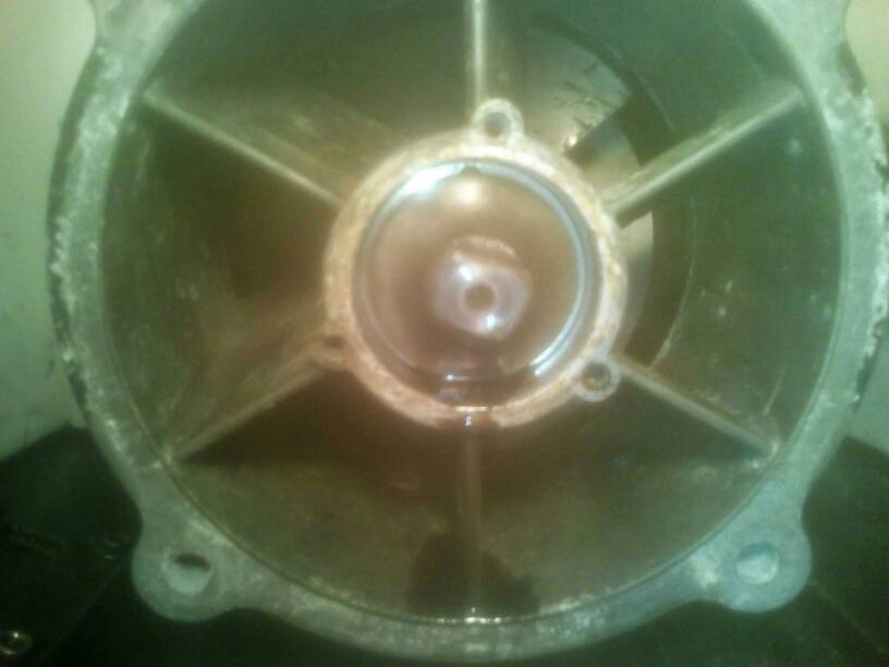

Just took off the cone to change oil, am I missing something in the cone? Thought there was a metal piece supposed to be in it:
Picking up some Klondike 75w-90 synthetic gear oil today.
Not much old oil came out - how do you know if you have a worn bearing?
