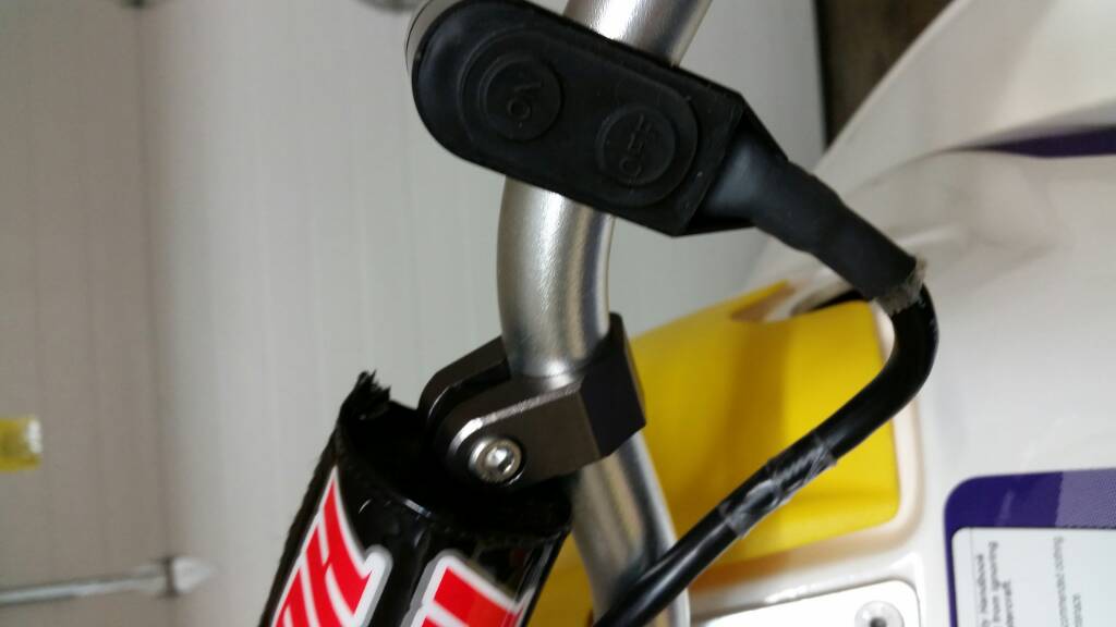

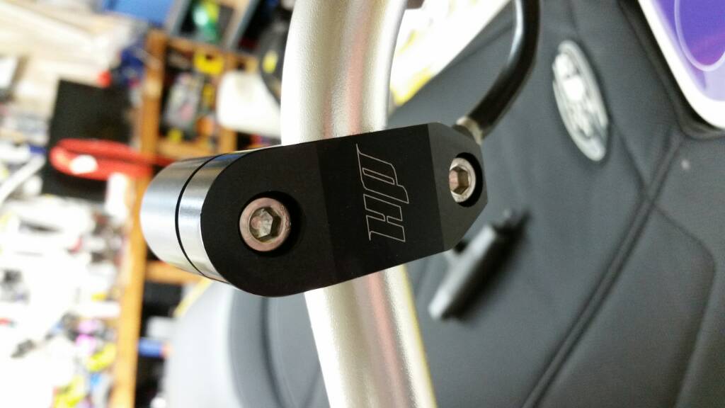

does anyone have a pic of a bilge pump switch that they would recommend?
