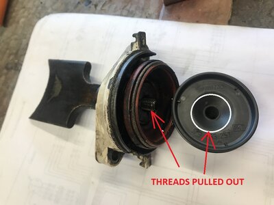

Pulled the carbs and everything looked OK. I pulled the Carbs apart, checked everything. Pop-Off Spot on. I swapped the CDI just to see if I had a computer issue... All Good. Before I embarked on tracking down an electrical issue, swapping the computer, checking all the plugs, maybe replacing the mag pick up... After saying a prayer to help me find the problem a thought popped into my mind. Check the Rave valves. That seems silly to me as I just built that engine and it has 2 hours on it. Sure enough the threads were pulled out of the MAG rave piston. That describes exactly the problem I was having with my engine. Jerky idle, great top end, and the reason my wife's ski jumped mine at mid-range. Notwithstanding all of this stuff.... her ski has always been faster than mine, even with the old engine. I wanted to get them "even up" using conventional methods... no cheating. :D With the new engine we were really close top end. I think My ski will hang with hers now. We'll see in 2 weeks.

I had to get the updated rave valves for my 97 GTX. They have slots cut into them. Before I changed valves I would have to hit the throttle two or three times very fast for it to take off like it should.
