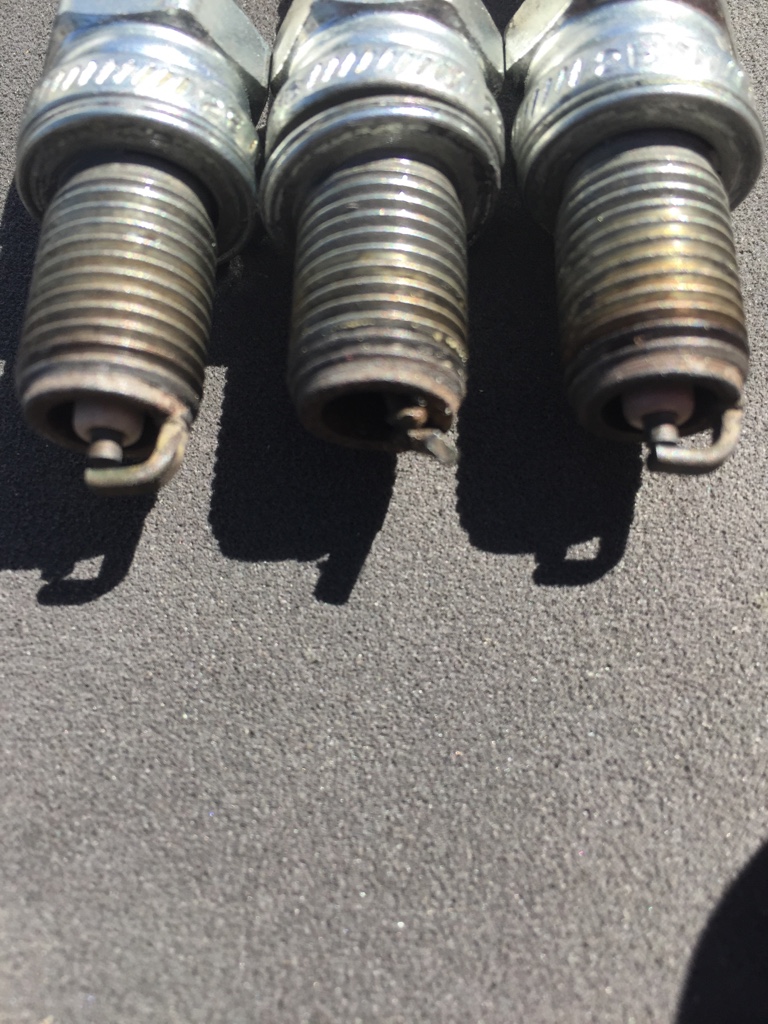

Dang! Worst thing to look at as an owner! Middle cylinder destroyed... Super Charger still fine
Okay guys... I appreciate all the help... Just want to keep you posted in the repair work for the engine of my boat! Obviously the motor has to be pulled! The thing is 9 years old... So I'm not really that pissed.

sorry to hear, does any one know what happen to actual engine?
Hey Hey... So far the one tech told me that the valve went... Interesting to me, guess it's common in the 215... The guy I bought it off of was the original owner and he only put 55 hrs on it... So that's only 6.5 hrs a year... Oh and the guy live on the west coast of Florida... I think it's a typical case of me getting stuck with a boat that wasn't used enough... You use a SeaDoo boat a lot and what do you do after? You flush it and maintain it spray lubricate all over the motor and make sure it's staying rust free... You use it 6 hrs a year and it's just not enough... I'm more of the use it once or twice a week guy... That'll definitely bring out the imperfections if an older boat wasn't maintained properly
the earlier engines had hollow, i heard sodium filled valves! i'm not sure what year seadoo changed the valve design, but it maybe worth changing in the near future after hearing your episode.
I'll know more next week... The engine is being removed either Monday or Tuesday and I'll pictures of all of the damage
The 06 had two piece (welded)valves,then recalled for solid one piece valves.The valve ends were breaking the weld off. I was just told this today.Wonder which valves I have.Im considering pulling my head and put new valves in.Maybe the candoo will tell me it was in for recall valve replacement .Heck if I know.

If your valves are stamped with the number 72, they are the old style hollow core. If stamped with number 75, they are the new solid core style.
Thanks ,Great info! I just seen a new valve set for $500. Man it'd be great to know what I have.I don't even know the hours on this boat.haha guess I'll have to be like Mike (OP) and just get'r done!

(Ok took one for the team cut into a # 72523 T Exaust valve and its solid see picture, if your valves are 72524 T K , those are the ones you need to be worried about as they are not solid, )
I found that info on another site.Mike it'd be great to know what valves you had.I tried reading mine in the dark will try in day light .Its tight but with a dental mirror I might see better tomorrow with someone holding light. Also read there's a known oil sensor that goes bad,puts boat in limp mode or wouldn't start.Not starting might have been neutral switch .The oil sensor is by the oil filter,$35? ,10 minute fix.I guess there's not really a lot of issues with this boat.I've seen 2014 bmw bikes with a ton of issues.So a 10 year old boat that should have been fixed,recalled back then .And such few other issues that are known,I really think it not that bad.
