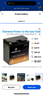

I am brand new to owning jet skis by the way. My 1999 GTI will not crank over it will click and turn over once sometimes. The oil light is on and flashes/dims when I crank. I have a brand new cheap Walmart battery in it because I just bought it and the battery was dead. I have honestly had good experience with the cheap batteries and I don’t want to pay double the price if I don’t need to. I heard that these can be picky about the battery, the key, or the starter solenoid can be the problem but I don’t really know where to start. There is currently no gas or oil in it. The battery tested 12.5 volts. Let me know if you have and idea what’s going on. Is it hydrolocked with oil? (Previous thread)
