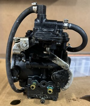

which of the three nipples feeds gas to the carb?
My 2000 sea doo gts starts when I put premix right in the carb, but won’t run otherwise so I think it’s not getting fuel to the carb.

You better be rebuilding that carb with all new Genuine Mikuni parts. That green goo is bad and needs to be corrected.
You're right. I cleaned the carb out, it wasn't too bad inside, cleaned everything with carb clean.
In the meantime, I am getting fuel through the feed line to the carb, but it's not pulling in. Would this be a Pulse line issue? I pulled off the pulse line from the carb and can feel air when I crank the engine. It just won't start.
